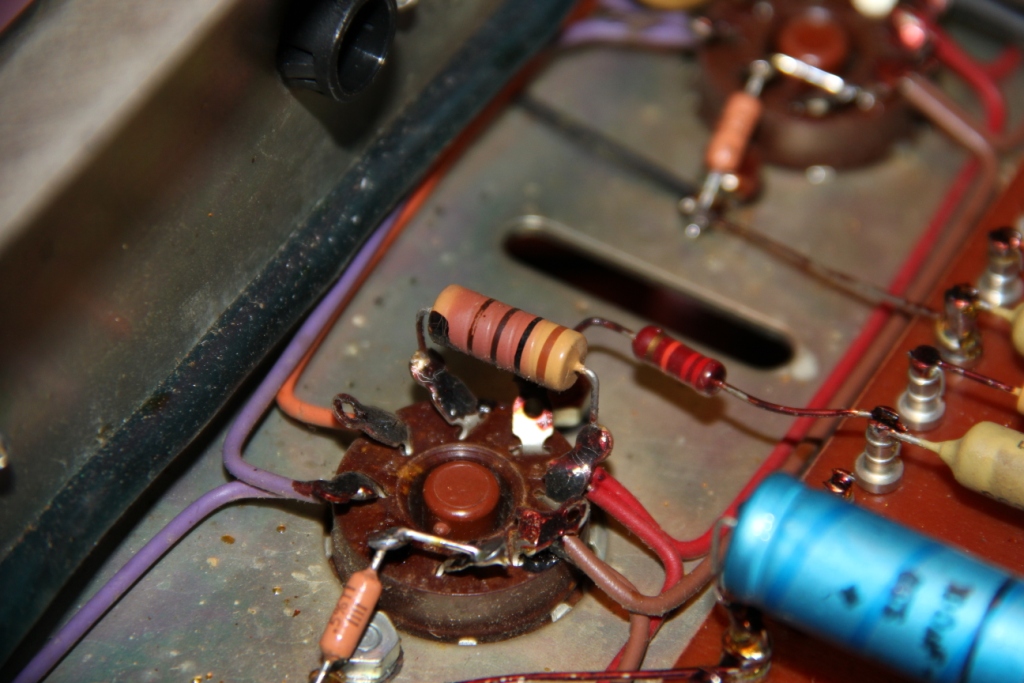

2. My screen grid resistors are all discolored like this:
Should I replace them?

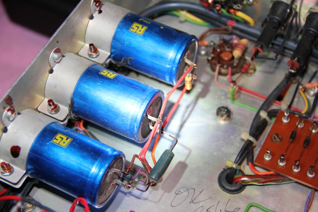

3. It's hard to photograph, but all the caps have a little bump as shown on the center one here:
It is in the exact same place on every one. Do they need replacement?

As long as the screen resistors still measure 1k +/-5% they should be okay.
The electrolytic cans need to be replaced.
