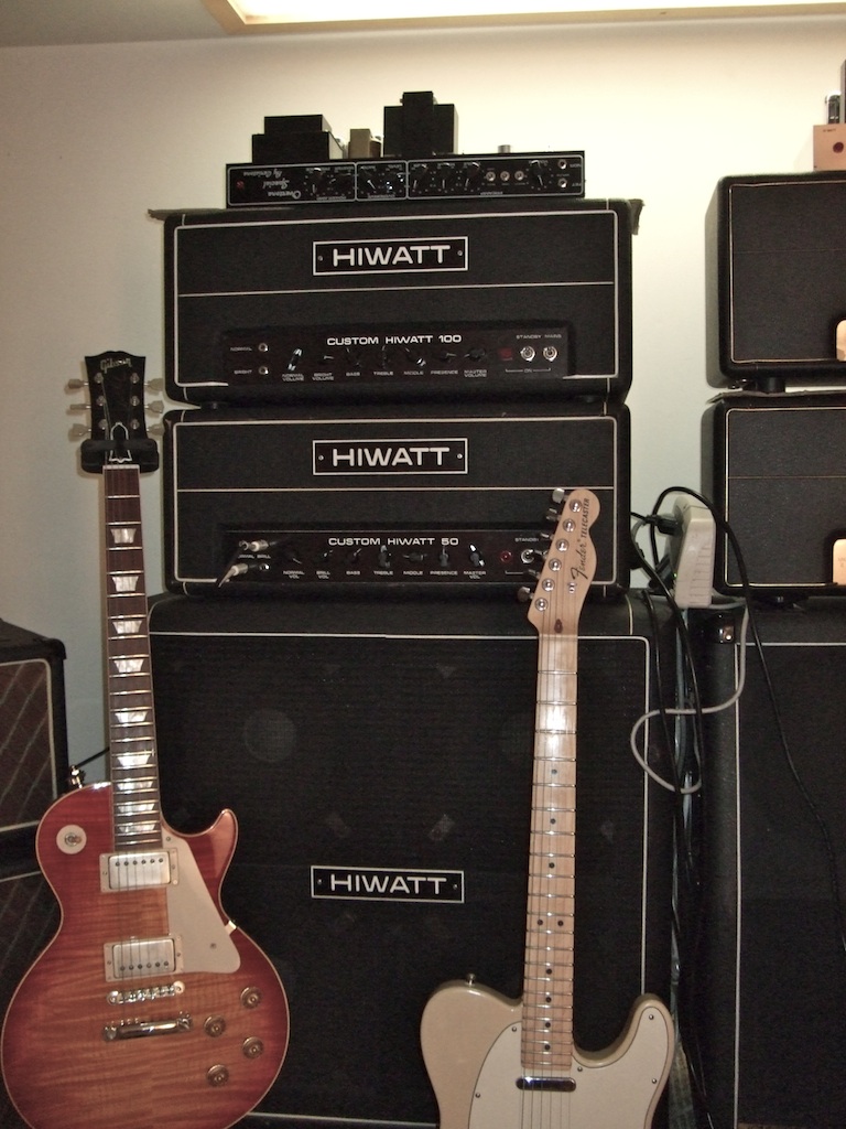

Hiwatts Rule!! :twisted: I've had a lot of amps in my collection and nothing, I repeat, nothing is as loud or as sweet as my Custom 100. Two JP100s being built as I write, for which I will need cabs. Once I have some decent recording gear I will post clips.

clusterstudios wrote:Hiwatts Rule!! :twisted: I've had a lot of amps in my collection and nothing, I repeat, nothing is as loud or as sweet as my Custom 100. Two JP100s being built as I write, for which I will need cabs. Once I have some decent recording gear I will post clips.
Clusterstudios ! Are you saying that your 100 watt is sweeter then your 50 watt ?
Thank's!.....................Louis :roll:

50 watter is not as loud as the 100watt and it breaks up a little sooner. that's the difference in a nutshell. if you want it loud, go for 100watts. otherwise a 50watter is more than enough. 8)

GigawattCustom121 wrote:Nice hoard of British amps!
