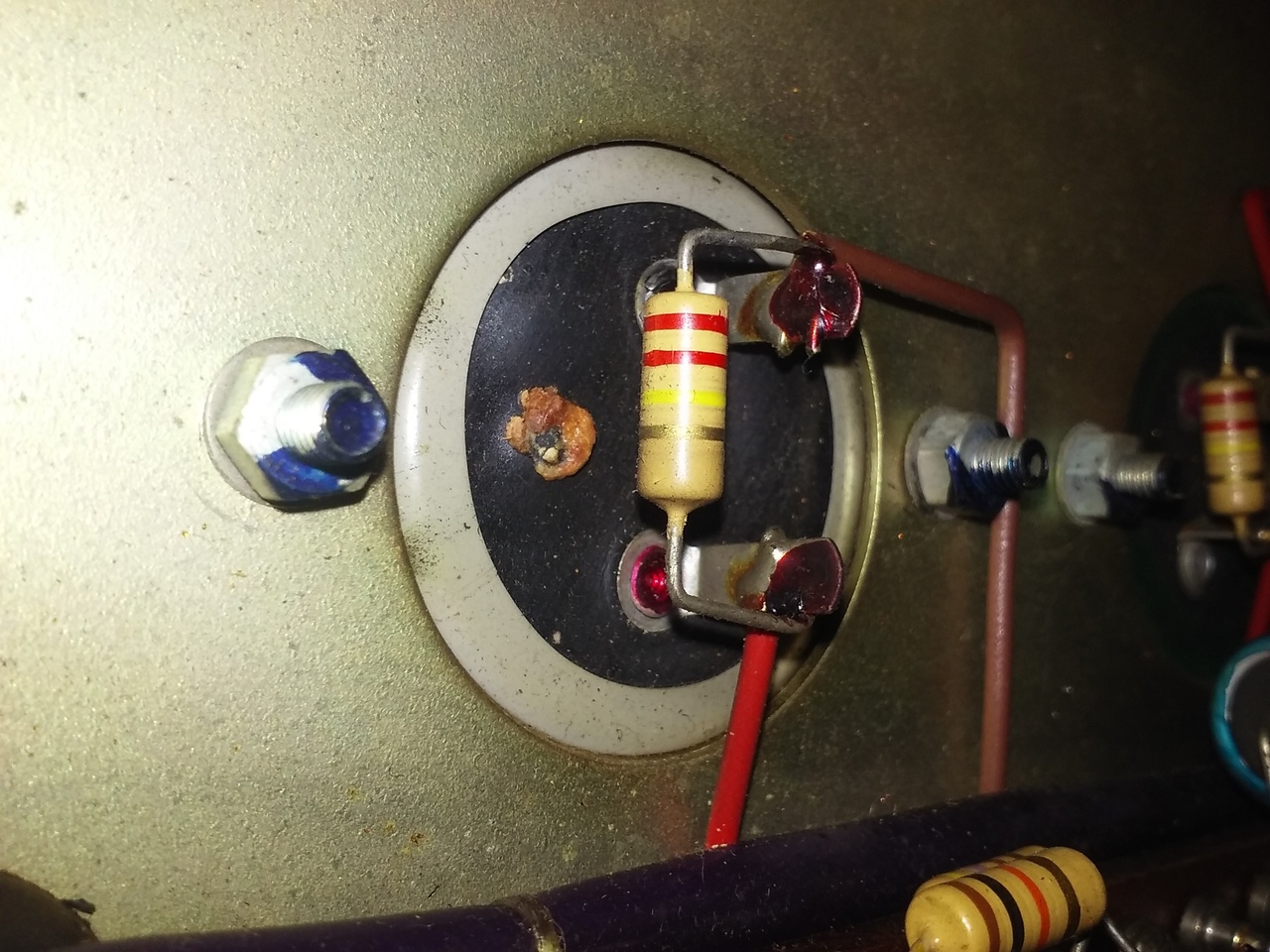

Post by durike »
thank you all. as you can see on the photo, change has to be done very soon I think.
they have those 100uF 450V http://www.hificollective.co.uk/catalog ... citor.html
or TAD has siemens http://www.tubeampdoctor.com/en/shop_Ca ... adial_4352
but I think I order that F&T since you recommend them. at first I thought about JJ as they are made in my home country... :)
