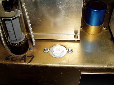

Like I mentioned, the speaker leads may need to be desoldered in order to remove the chassis. Not Hiwatt's finest design moment :? .
Because my SA212 was not a museum piece in the first place, I wired a jack into an empty power tube hole in the chassis to faciliate dismantling:
SA212 Speaker Jack mod.jpg (160.94 KiB) Viewed 4365 times

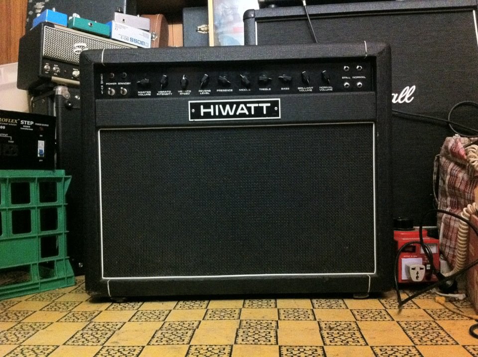

Mr Snarfus and I did manage to pop in to the store yesterday but were not able to take the poor thing apart to get a closer look at the guts. It was late in the day and the store was quite busy.
In the flesh, it looks about the same as that photo, except there are a couple scrapes through the tolex to the cabinet (top right cabinet edge and one on the back).
It was definitely 100W, and had both partridges in it. Celestions were celestion-rola G12M (didn't go looking for date codes).
Output tubes were some tired sounding JJ EL34s. Reverb and trem were working, though the trem depth was less than one might expect with the intensity control maxed. It was a bit noisy, more hum and hiss (with no input) than I expect to hear from a Hiwatt in top form. :(
Looks like the serial plate had been popped off with a screwdriver or something, as the rivets were still there, with traces of the plate under the heads. The store guys have no concerns about the provenance of the amp (it currently belongs to some reasonably well known muso whose name escapes me again and I know they run a tight ship - that place is a bit of a melbourne institution for trading gear), but I still wonder if it has a bit of a 'history'. I can't imagine too many legitimate reasons for tearing off the serial # plate. I guess it's possible it got torn off by the amp rubbing against something else in a van or car though.
Basically it was a little tired and sad looking/sounding, but probably still a good candidate for being brought back to top form.

It looks nice in the picture.
can you post internal pics of the "guts" ?
