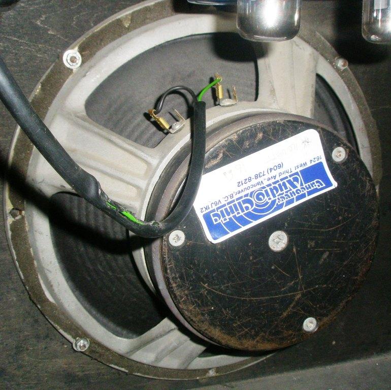

Thanks for the Thames tip -- I suppose you meant the Alnico's? Ted Weber is swamped with orders -- I suppose he's doing something right. I wish I knew what my current speaker actually was; it certainly sounds OK -- i'm just in tweak mode. Can anyone tell by just looking? Perhaps my "no-name" is one of the old grey- framed Fanes...see att'd. - Sean
100 watt 16-ohm (Fane or no-name?)
100 W 16 ohm Fane or no-name.JPG (122.19 KiB) Viewed 1829 times
Re: speaker/tubes for 1980 50 watt Bulldog
No I would not recommend Alnico speakers for a HIWATT. Ceramic is the way to go. That speaker is an ATC and was an option for that amp. Can you describe what you don't like about it? That ATC should be an outstanding speaker.

I've got the same speaker in my 1977 Bulldog. Mine is 8ohms though ( maybe check the impedence). I don't think a different single speaker will sound much better just different. Consider adding a 1or 2x12 cab for variety. At 36kgs( for the amp) a set of casters on the cab work nicely---RM

To be honest there's nothing I don't like about the speaker -- I'm just assessing my signal chain and I always wanted to have the speaker that was "meant" to be in there... ATC I had never heard of - sounds like maybe it's a legit contender. The speaker in it has a Vancouver audio clinic sticker that says 100 watt - 16 ohm. But yeah it does sound great with my 2x12 marshall (w/the venerable GT-75's). In fact waaay back when it was last serviced (locally by the guy who built those Wizard amps that ACDC used) he plugged it into two 4x12 cabs. very cool. As for castors, no it didn't take long to add those. Thanks for all the feedback. I bought this thing in '89 after the first band I was in had a guitar player that insisted I use his rig when I joined them - a 100 watt hiwatt head and an orange marshall straight 4x12. I guess I got hooked. -- sean
