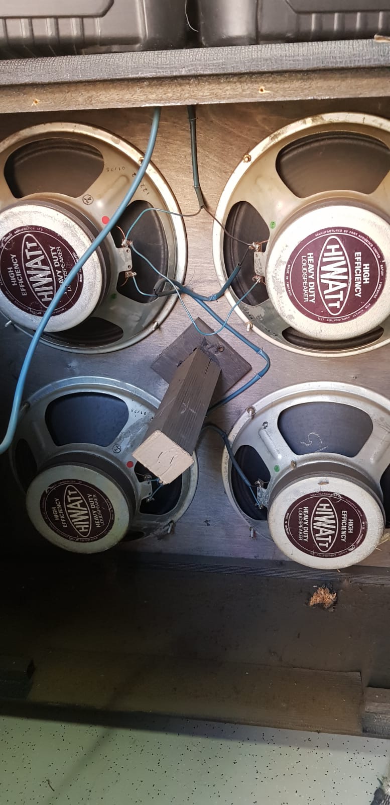

Hi, my name is Rainer, I'm from Austria/Europe and the owner of a ´75 DR103 and a ´76 SA212. I want to post some pictures from a vintage SE4122 I want to purchase. I want to know if the speakers are the original ones, the cab is an old one and so on. Maybe you have some time to send me a short message back. Thank you very much!

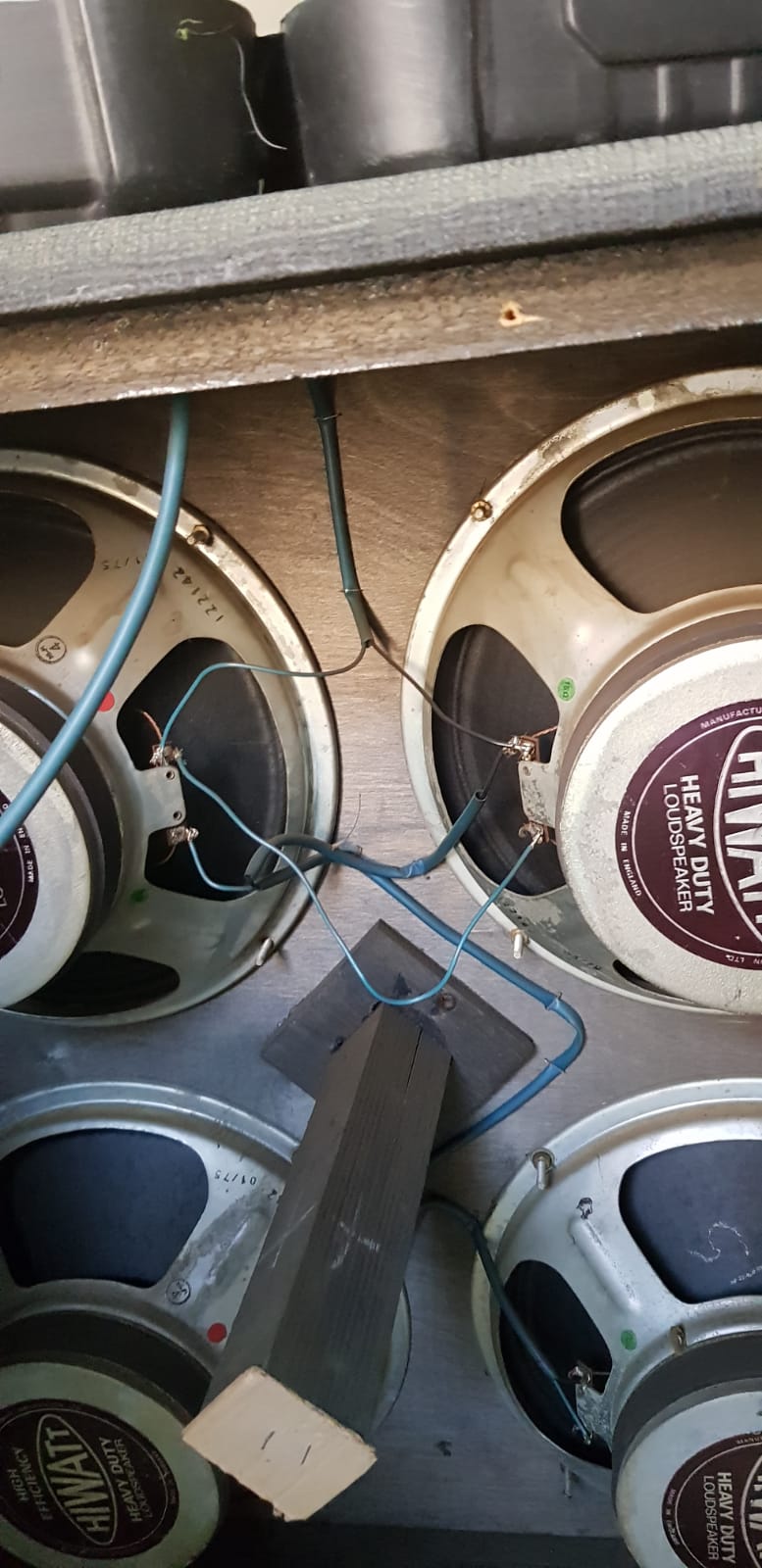

seems all original to me.

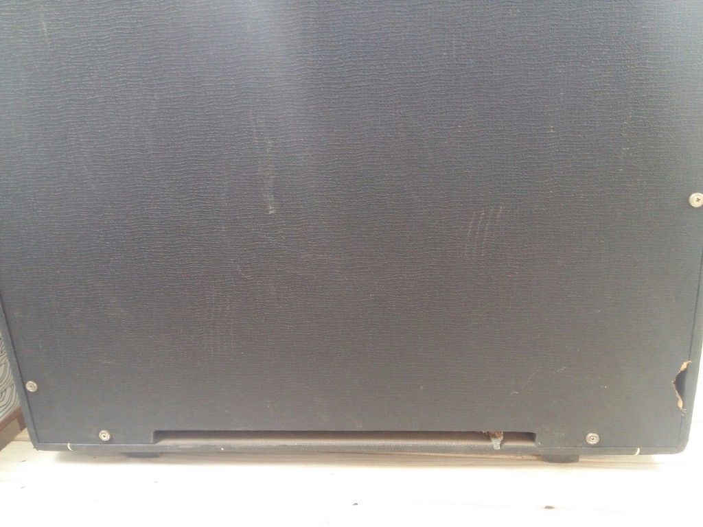

the top 2 speakers have had some wiring added and some idiot has taken a chunk out of the back board (probably trying to get it off with a screw driver) but the piece seems to be inside, so maybe you can repair it?
how much are they asking?
Re: possible deal SE4122
I have blown several of those 122142 from 1974 with the stamped/pressed frames.
I don't know if there was a production problem with them, but they are not very rugged.
unless it is an incredible bargain, I would pass.
an early 1970's SE4122 with cast frame 122142s or an SE4123 with 122231 or 125161 drivers.
