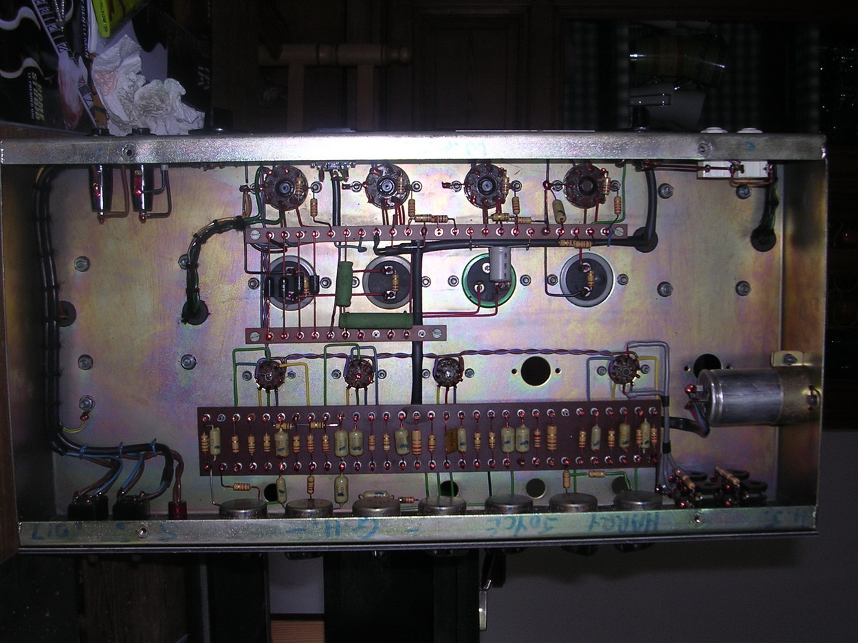

so I just got my new to me 1974 DR-103 and with the exception to a couple of tubes it all original. the caps do look like the above listed ones. should I not even play the amp till I get it repaired? i went to VHR and saw the cap kits and there are 3 different ones which one is the one for my head? is there anything else i should look into changing on it? played it for 15 Minutes and it sounded amazing and quiet with little to none of tube noise. any help you guys could offer would be greatly appreciated.

here are some pics for your viewing pleasure
Re: You might need a cap job if.......
Nice Rig!!!
It is due for a recap. For a direct replacement of the exact values in your amp you would want the 16+32 kit. However the 32+32 kit will work perfectly well, with little effect on the tone.
Do you see the leaking bulge on the 50+50 cap? It is one of the center caps in the row of four mounted along the midline of the amp.
Recapping is just maintainance that should be done every 12-15 years if the amp is going to be gigged regularly. You might be fine to leave it as is for a while, but you don't want it to fail at an inopportune time.
xtoby44x
Post by xtoby44x »
Dr.HIWATT wrote:Nice Rig!!!
thank you so much DR. HiWATT! I think I'm going to order the 16+32 kit to keep it all original.
