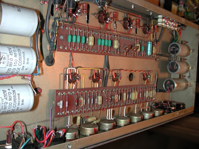

I noticed a strange mod on my tone stack board. It definitely does not look stock. On the pic, you'll notice that on lugs position 11 and 14, there might have been some component that is now missing. Instead, the top lug no.11 is hard wired to bottom lug no.14 and bottom lug no.11 to top lug no.14. Why? What can this achieve? Is refurbishing to original specs in order? My instinctive answer is: YES! But the amp sounds great atm. Could it get even better??? :) I'll start researching the matter...
Franz
Happiness is a glowing tube!
Re: First post!
Can you take some pics from straight on? Pics from screwy angles like the one above, aren't very helpful.

Ok Doc! Will do asap. It's been a hard day of shuffling yesterday and I'll let it rest a bit. But I think it's easy enough to see that two pieces of wire are soldered in an X-shape between the lugs in position 11 and 14 starting from the left.

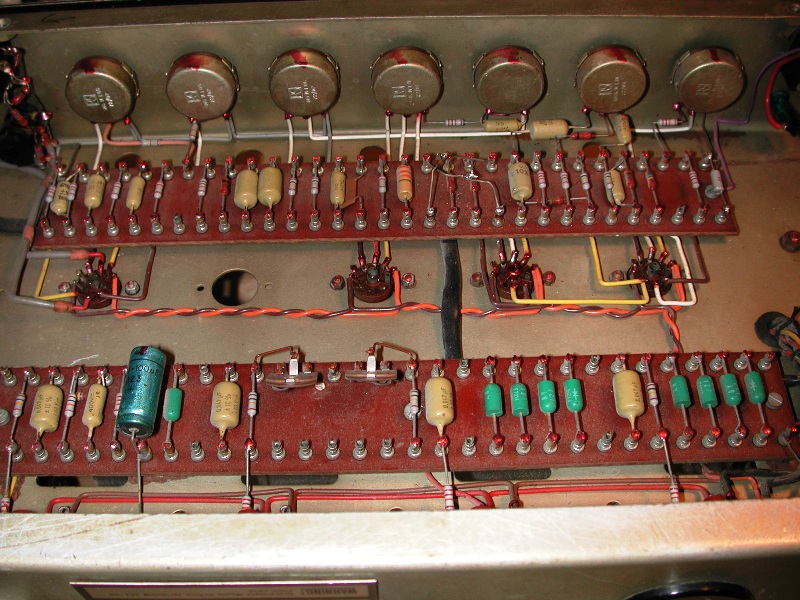

I found this other pic which may help in the mean time! :)
Franz
Re: First post!
here is a pic of my old '72 DR201 #3049
the buss wires should run directly across the board. I am not sure what is up with them being crossed on your amp.
My guess is that there was a mod there that someone tried to un do, but it would be best to study the schematics and then know what is going on there.
