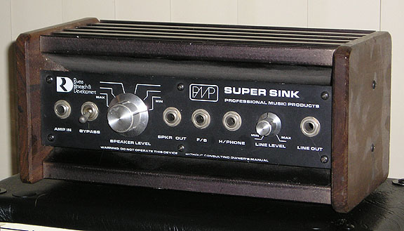

About the rivera attenuator any ideas? It's made from the beginning 80s and it looks sexy:

I haven't seen that one before. It likely is a simple resistive attenuator like the old Marshall Power Brake. I would get it if the price is cheap enough and give it a try, but don't pay collector prices just because its vintage.

I think also the Rivera is an resistive attenuator. Price seems little high at € 200,00. Saw one review in the past where was written it sounds much better then the Marshall Power Brake, but who knows....At this pirce i can get also a Weber Mass at ebay. Don't like TAD and THD becase hey are fixed to one impedance.
