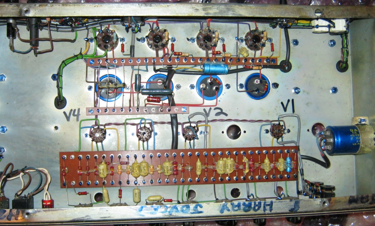

1. Is the amp recapped and if not - does it need the recap or is fine for now?
2. Is there any seen modifications?

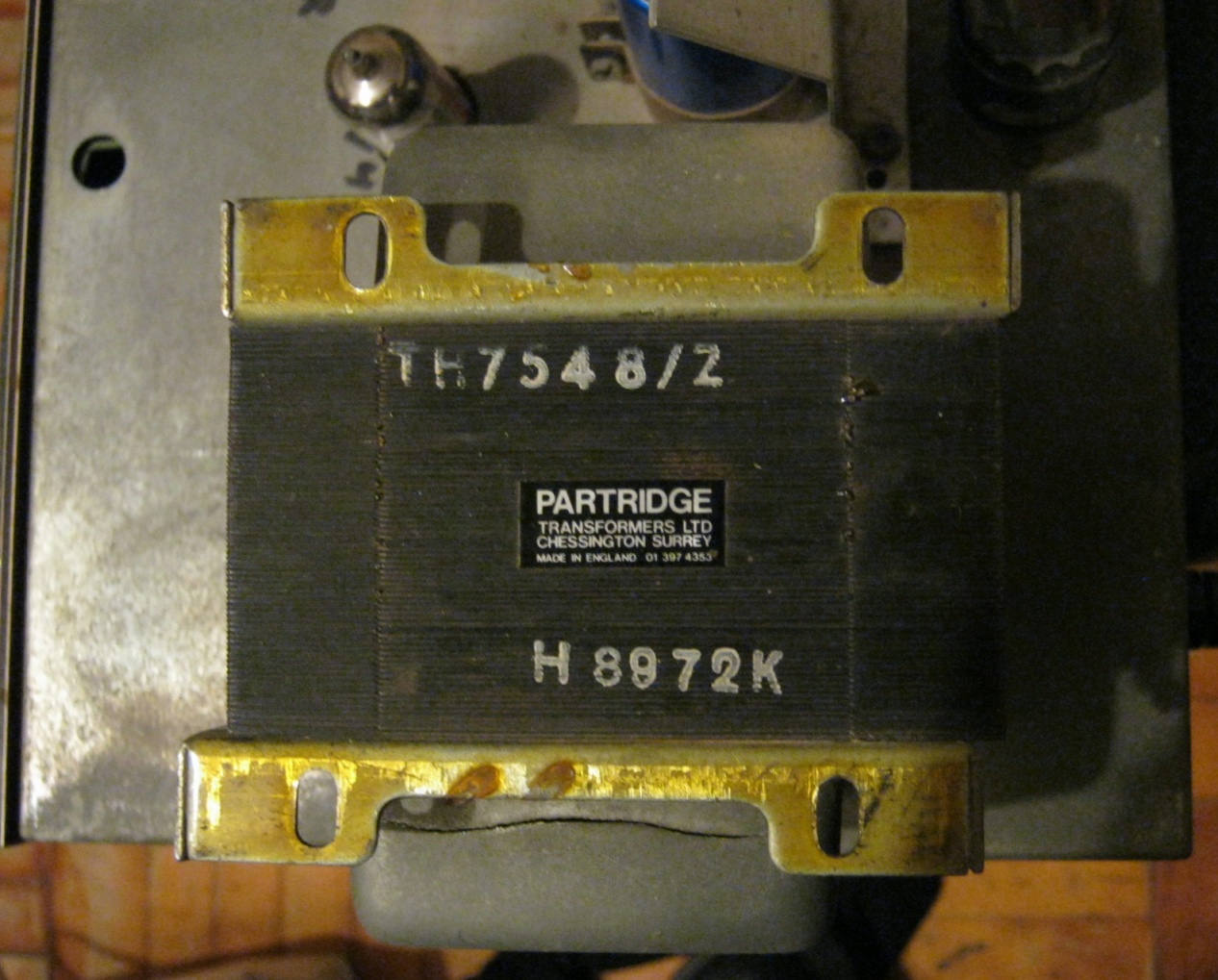

3. There's a crack on one of the transformers (picture №4) - is it critical or doesn't matter at all (seen some pics of other partridges - seems mine have a crack just in cover)
4. I'm not sure if the amp was used or not without voltage selector - as I understand it could but then it means it was wired internally for one of the voltage options so I need to unwire it for using with selector plug. Please tell if it was wired internally (if my pics are detailed enough to see this)

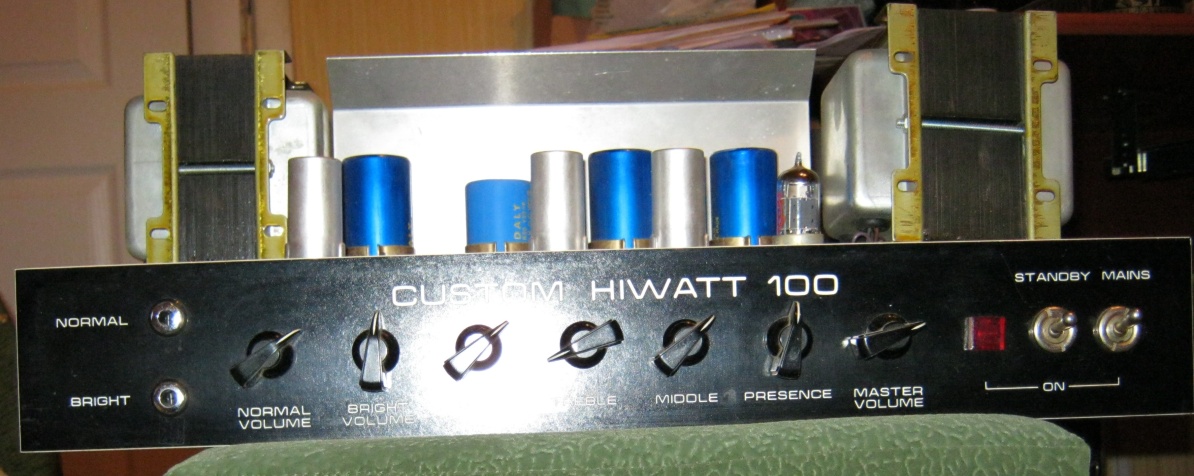

Here are the pics of the amp (if needed more detailed or different angles - please let me know).

it has been hardwired for 115v.
The cracked cover on the transformer should not be an issue.
If you are going to gig with it, it should have a cap job. if You are just playing with it at home it is OK for a while.

Obviously, the Mains fuse holder is a replacement. Also, whoever labeled the preamp tubes inside the chassis made an error. "V4" is actually the middle of the group of three.
Other than that, it looks like a fairly unmolested Hiwatt. Congrats!

And thank you for tube number correction - it's very important cause I'm going to try NOS Mullards and ECC81 in the PI (V4 is the PI, am I right?)
Re: My first Hiwatt DR103 (1979) - is it ok?
correct V4 is the PI
you will have to fix the mod to operate it at 220v.
simply putting the plug in will probably destroy the transformer without correcting the mod.
remove the small section of green wire that connects the brown wire (from mains fuse) to the 115v lug on the selector.
solder the brown wire to the center lug of the selector.
