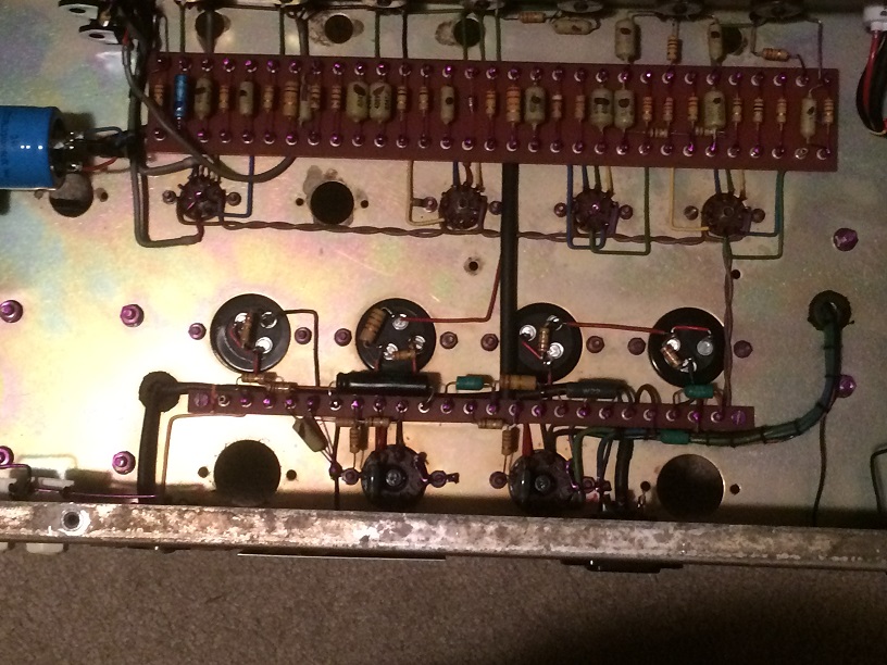

I have a 1977 Hiwatt DR505. It's in fairly decent shape with a few bumps and bruises. It was missing the back panel and the heat shield when I bought it. I have made replacements and they look great. There was a cracked indicator lamp which has been replaced with a new one from VHR. It has matching partridge trannys and new production preamp tubes, with some very nice vintage GE 6ca7's in the power section. It's been recapped with JJ's and was told it was professionally done. All in all, a very decent amp! Aside from the cap job and the Canadian gain mod, I can't find another non original solder joint. Is there anything that I can't see that's been modded? Here's something else that is weird...."Harry Joyce Canada" has been blacked out (but has faded to the point you can still see his sig.) and "Bob Dickson" is written beside it. It also has "Quantem Leap" written on the inside of the chassis near the mains switches. This was weird for me when I initially looked at the amp, but all the original solder joints made me pull the trigger. I think it may be the Canadian mod "modder" that has decided to write his name and the name of his band on a then new prodution amp. Just a theory.....Any thoughts?
So onto the cap job.....It looks like they've replaced the originals with JJ 100uf/500v cans. Has it been wired up correctly to achieve the same value and the original 220uf caps? Also, the value of the axial cap is 100uf/100v, is that the correct value for a DR505/504? If not, should it be changed out with say, a 150uf?

Re: 77 DR505 Crituque Needed!
Nice score.
For bias, I'd just add the bias pot. The 50s don't have a problem with the amount of bias voltage.
I would lose the CA mod as well, but that's just me.
The recap job looks decent. The JJ caps are fine and there's no need to fuss with them.
