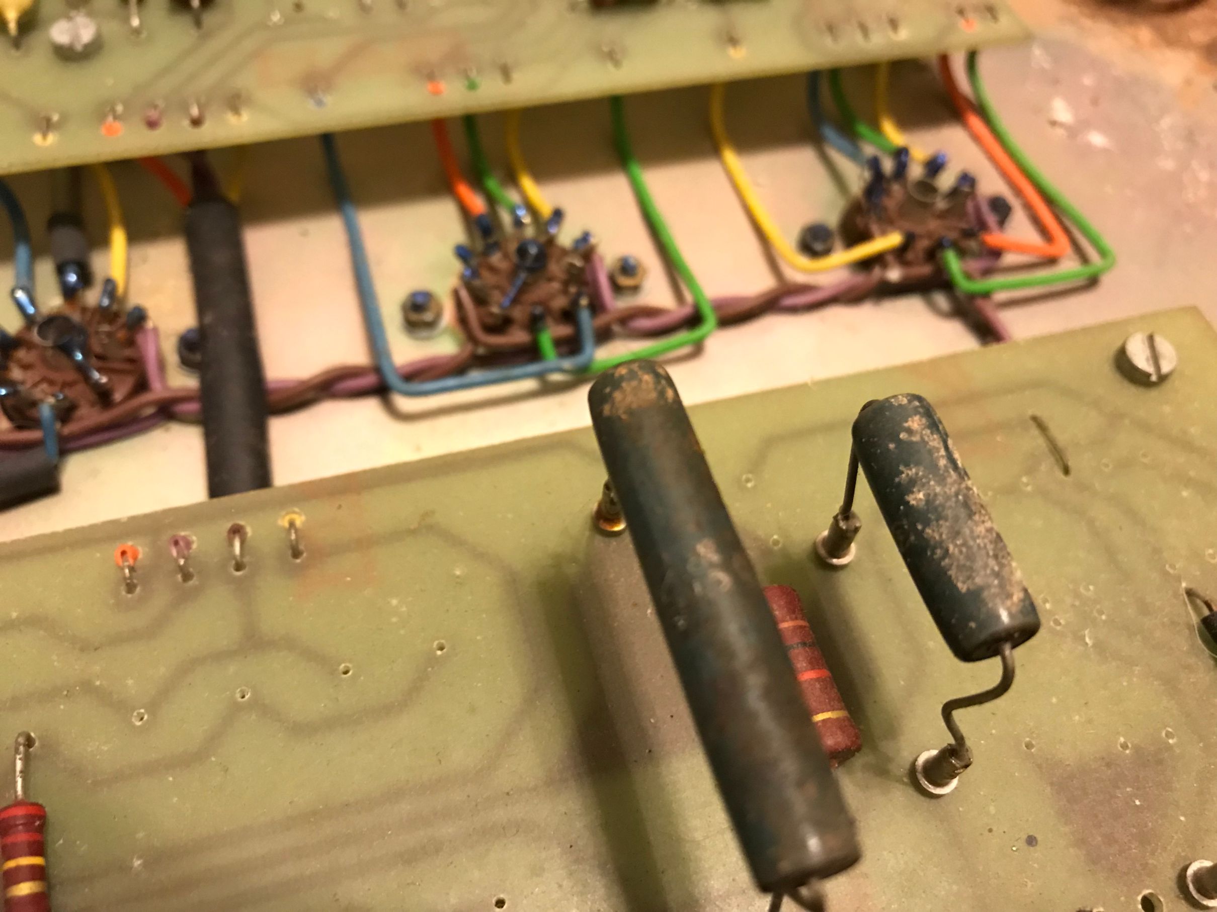

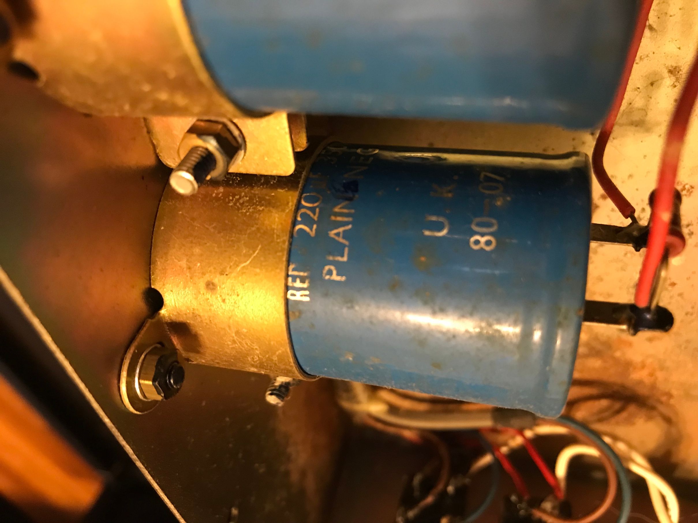

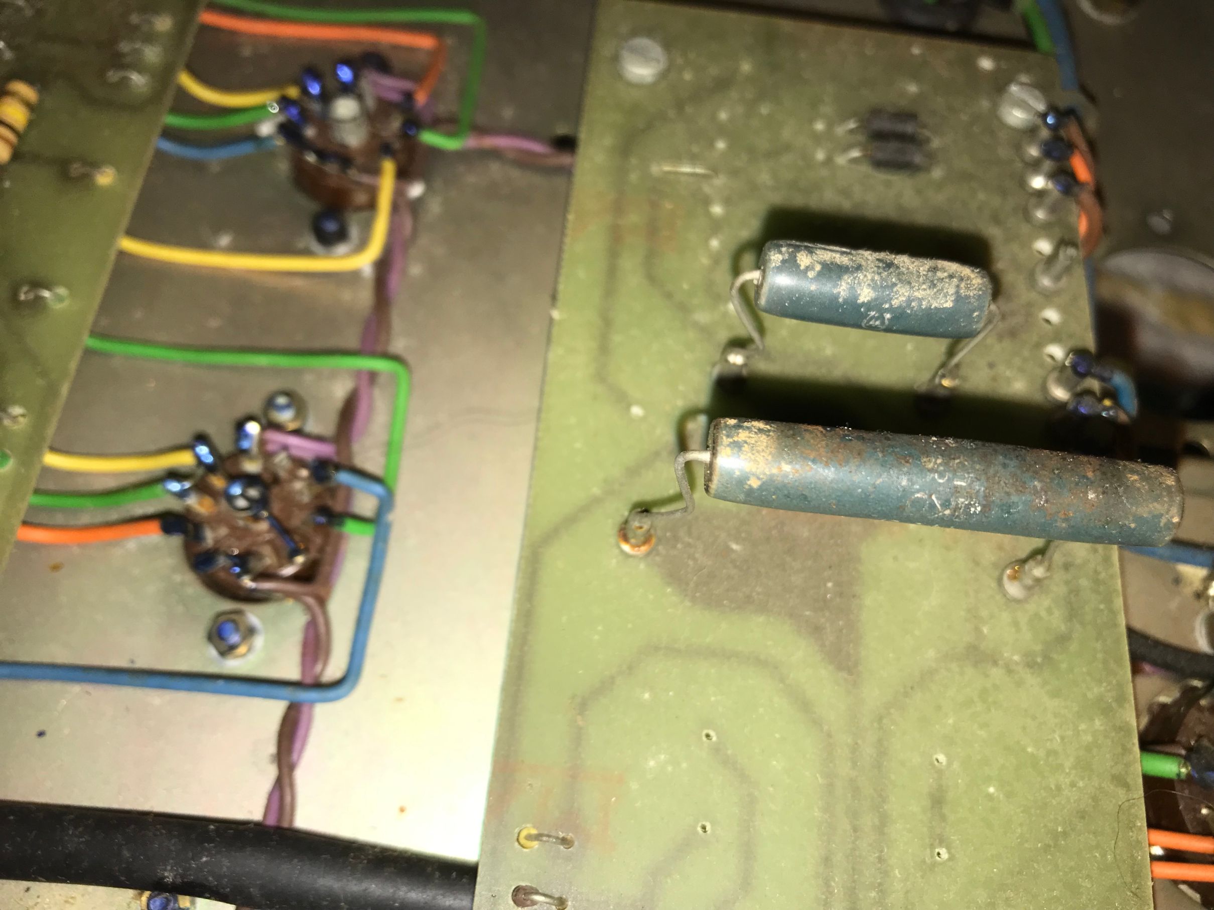

- Caps that have a small, but noticeable bulge

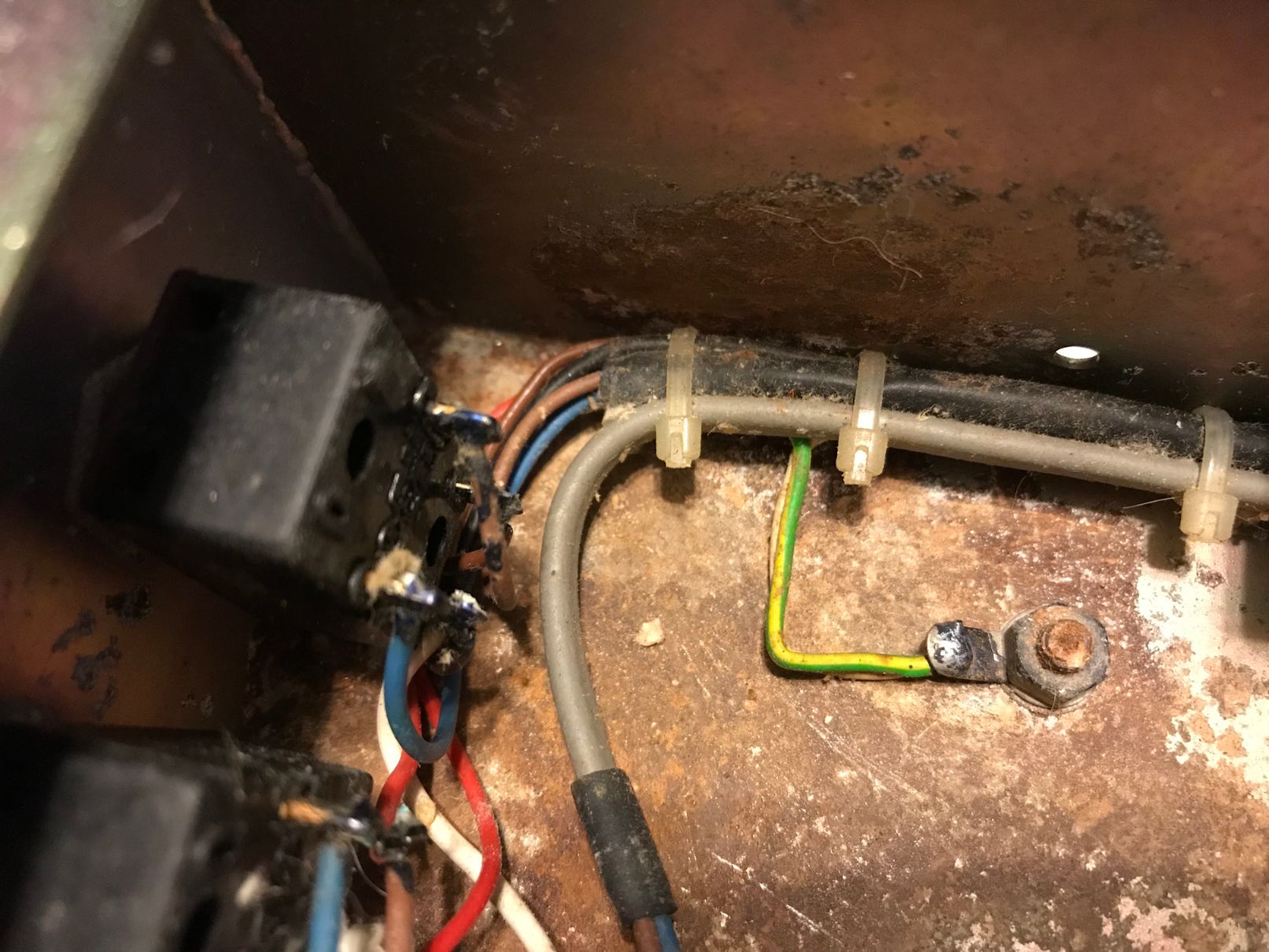

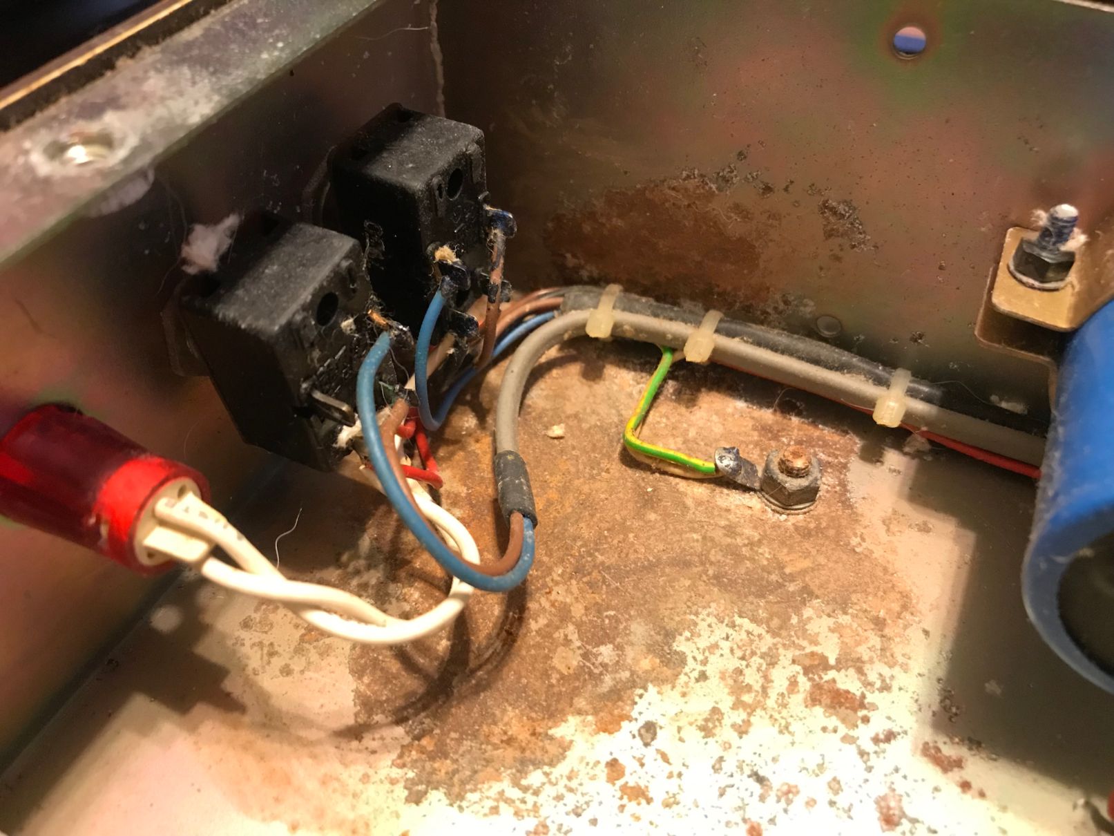

- Yellowish crud on the surface and interior of the amp. This residue covers almost all of the components on the inside of the amp. I'm thinking this is either from smoke, or oxidization of the chassis. I've read that yellow residues on metal surfaces can be Cadmium Oxide, which is a class 1 carcinogen.

2. Are there any good places to get F&T (supposedly the standard...) caps that are compatible? From what I've read, these are 220uF 350V.

The yellow stuff does not look like Cadmium to me, more like the stuff left over from when an electrolytic explodes. Do all the caps look original (including those on the 'back' board)?
I've never seen a Hylight chassis with a plating problem.

The caps do look original (all have the blue paint on the solder joints). There are no caps on the back board (if I understand the backboard to be the other side, where the tubes are mounted). Just side-mounted in the chassis. This is one of the last runs of Hylight era amps. Probably a 1981?

I'm thinking I could replace the side-mounted caps. The soldering looks extremely basic. To feel comfortable, I'd have to have an exact match, though. A lot of the caps only have two terminals. I don't even know what the difference between the two/three terminal caps is.

There is one small electrolytic cap on the power board (see attached) for the Bias supply. A lot of inexperienced techs will put these in backwards when replacing them, because connecting the '+' terminal to ground seems wrong (in the U.S. at least
The fluffy looking yellow stuff on the switch terminal in the corrosion picture looks a _lot_ like residue from an exploded cap.
I'd try alcohol wipes for clean up, but you'll probably need something stronger (a rust removal product) for the corrosion in the corner. That looks like Coke or something else acidic was spilled there, but I can't imagine how it got inside, much less into just that corner. I'd also loosen up the green and yellow ground connection and make sure that is cleaned up and making good contact with the chassis.

My SA112 is a dozen serial numbers "older" than yours. Going out on a limb here....any chance this amp went through a flood? I've not seen that type and extent of crud inside a HIWATT chassis.jinglejangle wrote: ↑Sat Apr 06, 2019 9:18 pm

To answer one of your questions; the caps with 3 terminals have two sections. One of the terminals is a shared negative, the others are (separate) positives. You might want to let someone else replace them for you. It's definitely an amp worth restoring!

I'm not sure what happened to the amp. I bought it from Guitar Center and they didn't really have any info on it. It looks like maybe someone spilled some soda/beer into the chassis?
