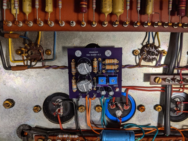

I finally got around to designing a PCB for the oft-needed bias doubler mod for DR103 amps. It mounts in the chassis using the existing holes for the "missing tube" socket.

very nice!

How do you know if you need a bias doubler?
Re: Bias doubler
If the stock bias is running the tubes too hot, a doubler is the best solution. You have to actually measure the output tube current to determine this (unless it's way out of whack, in which case the output tubes will start red-plating. :!:) About 34mA per tube is appropriate given current tubes and a typical 510-520v B+ using modern mains; I'd definitely recommend keeping it under 40mA.
