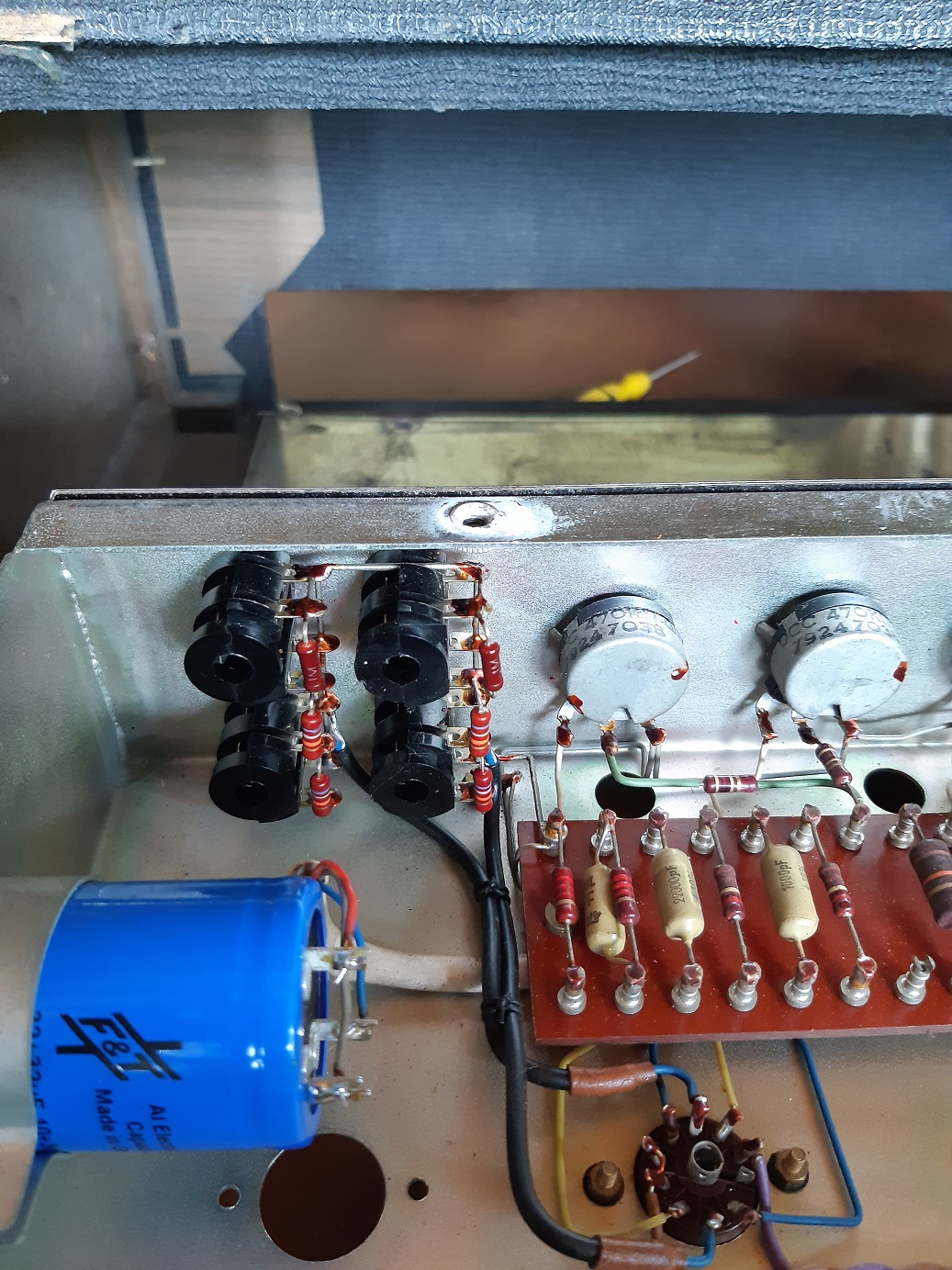

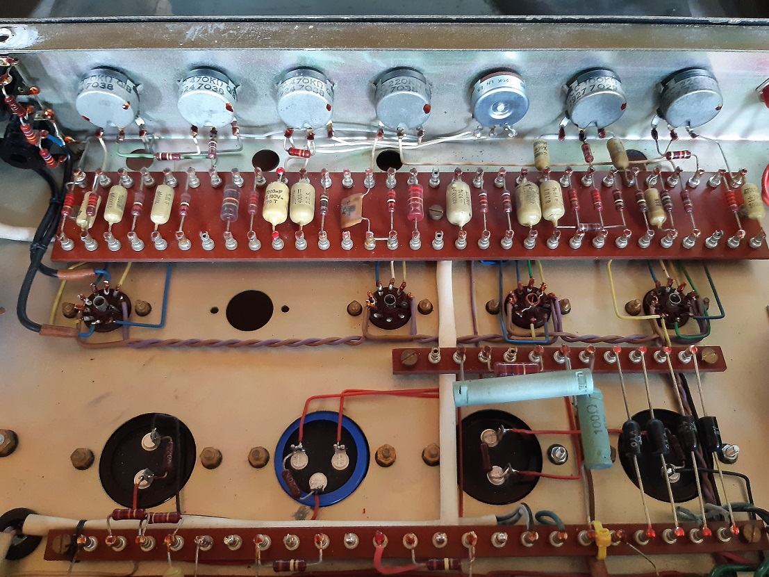

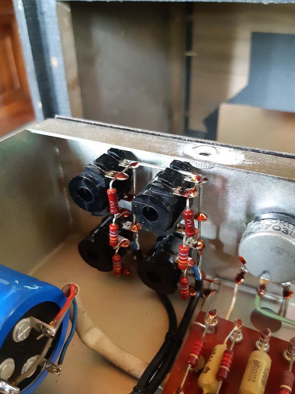

post some pics of the input jack assembly and the preamp board associated with V1 and V2.
jujub
Posts: 36
Joined: Thu Jan 31, 2013 12:23 pm
Location: France
Re: loss of volume when linked input
Post by jujub »
Here you are sir,
As you can see the 'middle' pot has been changed also 1 tone stack capacitor for bass was return to original mullard at 47n
INPUT JACKS
TAG BOARD
As you can see this amp is late 1970 (at least october) and so the layout is not the usual one !
Thank you !

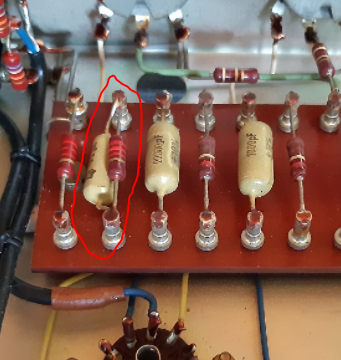

That looks fine. The only other thing I can think of is to test the values of the 220k resistors and 22n & 1n caps shown in your first pic above, and if they're OK, check the 2k2 cathode resistors and cap.
jujub
Posts: 36
Location: France
Post by jujub »
That big boy gone up to 250nF
