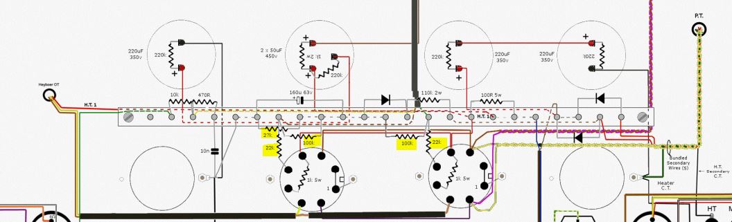

  • We've already had retighten every knob or bold and measure every resistor a found some faulty ones (broken or Out of spec) we replaced (highlighted in yellow in the attached photo)
Maintenance SA212.JPG (63.81 KiB) Viewed 5206 times
