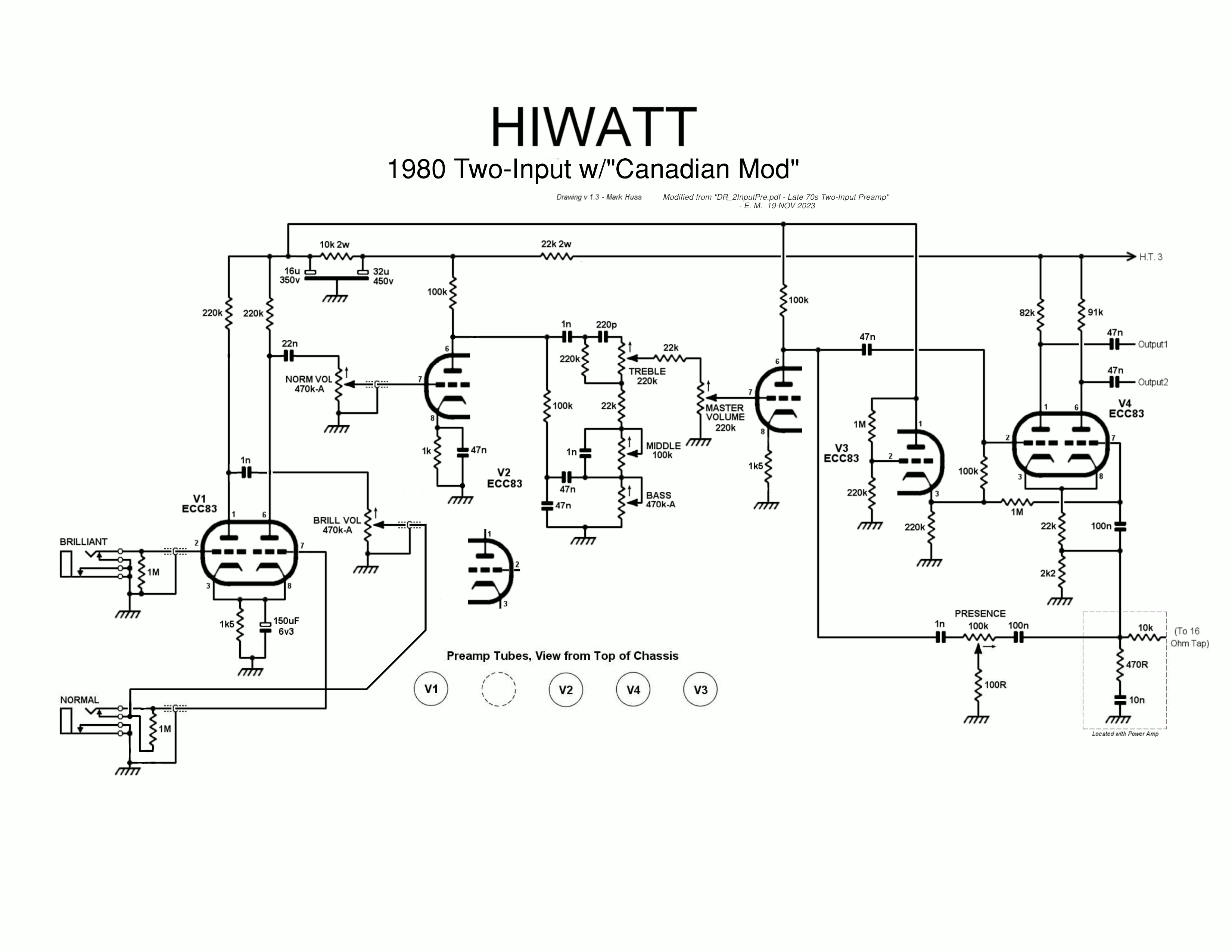

Hello all. As I said in my "Introducing myself" post, I have recently acquired a 1980 DR-504, serial# 14947. The previous owner said the last time he played it many years ago, it made a buzzing noise and quit, and never got around to fixing it since then. I have an Accurate Instrument Co. Tube Tester Model 257 (consumer-grade, good for testing go/no go) and the power tubes tested at about halfway up the "good" section of the meter, and no shorts. Two of the preamp 12AX7s (er... ECC83s, sorry) were bad/borderline, lucky I have two rattling around in an old abandoned project that tested good. The caps look meh... could be bulging, could be simply old, I'll replace them before I go flipping the thing on. I discovered Mark Huss' page that proved invaluable for schematics, but the signal path for this amp looks different from schematics he has posted; at first glance, it resembles a "Late '70s 2-input" AP up front with "Bright" and "Normal" inputs, but it doesn't use the second triode of V2, like the SAP schematics show. Also, it has the "Canadian Mod".

- I noticed it doesn't use grid stopper resistors at V2 or V3, would this be recommended? Or does it sound just fine without, especially on higher-gain settings? It's an easily-reversed mod.

I'll post more questions as I think of them, and I'll let you all know how it goes as soon as I can get new caps. I also took the liberty of modifying Mr. Huss' schematics to show how this one is laid out; see below:

I wouldn't worry about the grid stoppers until you try it out and see what it sounds like. I am not a fan of the CMod, it was a quick and dirty hack and sounds like it. :P

Ha! Yes, I should see how it sounds first. My pedigree is in the heavier genres, so I'm only hoping for enough grit to work with. Without grid stoppers, I imagine it can get a bit "spitty" at higher-gain settings, so that was my idea to smooth things out without losing grind.
