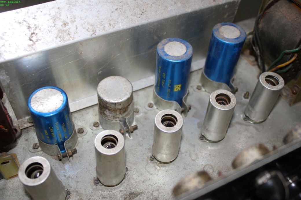

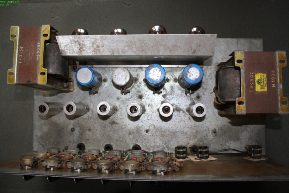

Hi glad to be here,
Thanks for confirmation of the cap values. I just double checked the schematic against the amp. I didn't notice that the 16/32 cap on the schematic is supplying the preamps so that makes sense - I was mixing it up with the 220MFD cap on HT3. So as far as the 220 MFD caps goes it looks like I am one missing.
Some pics below showing the four caps.

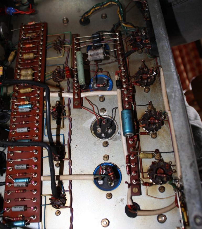

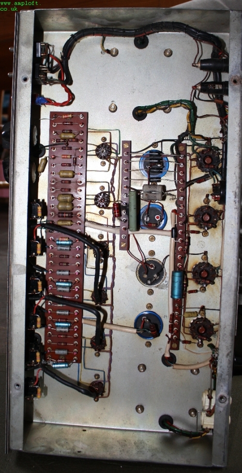

can you post a pic of the underside?
what is the serial number of that amp?
Re: DR112 PSU Capacitors
Sure thing . . .
Serial number is 1112 (dates it at about 1970 from what I can see on mhuss.com).
Attached is the underside picture of the DR112 and I can get many others pics if they can help.
Mike
Mike
- IMG_1128.JPG (191.42 KiB) Viewed 2300 times
- DR112 underside
- IMG_1124.JPG (426.87 KiB) Viewed 2300 times

Some work has obviously been done to that amp previously. The diode leads are usually straight as arrows. These have been bent (and one looks to have been spliced/repaired?). Also, the two grey resistors(?) next to the diodes aren't original.
Dr.Hiwatt has seen far more PA heads than I. I'll let him speak to the capacitors on the preamp board (I'd expect to see more mustards).
Cool amp, though! I'm keeping an eye out for one of those myself.
