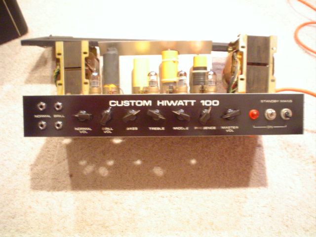

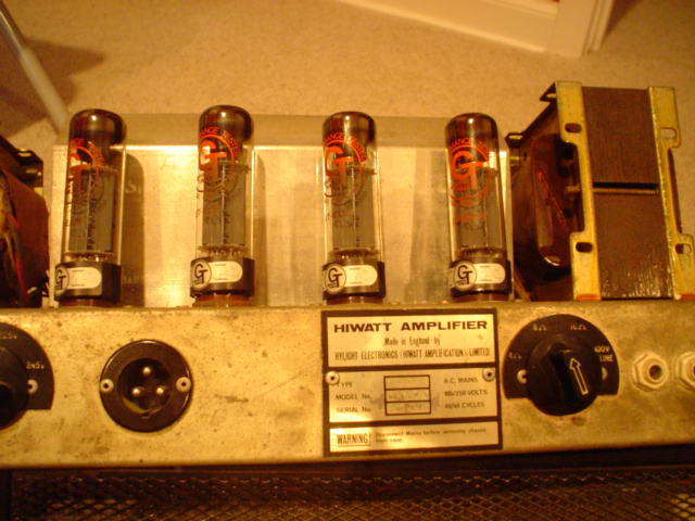

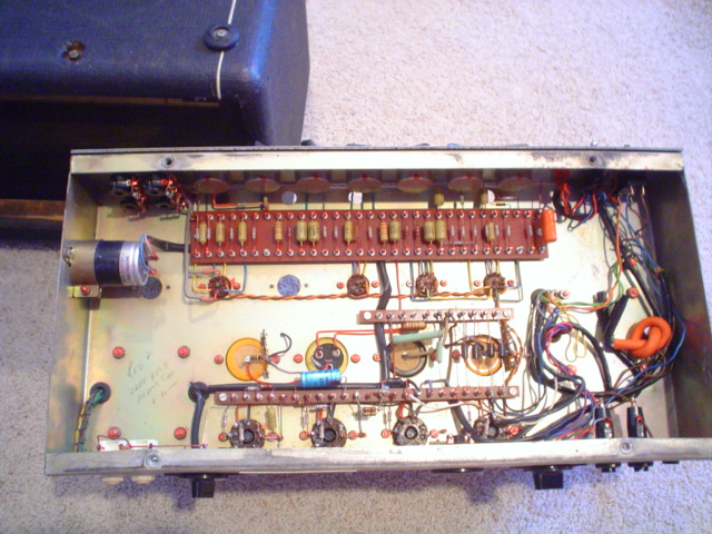

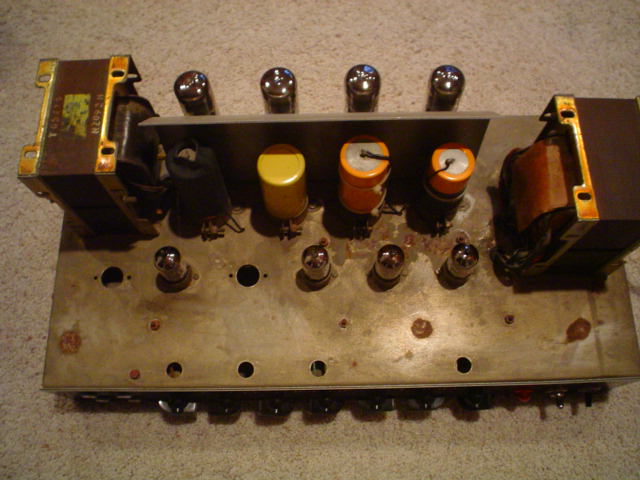

Here are the pics Matt emailed:
I see a replaced PT - a Partridge, but not an exact replacement - and sloppy cable dressing throughout that section.
A replaced MAINS switch
A replaced signal cap (orange one, far right on the preamp turret)
Strange filter caps with only one terminal (how does that work?).
Looks to me as if it could be set right fairly easily. Anything I missed?

Strange, indeed; those are axial caps, the upper terminal is wired through small holes drilled through the chassis. Clumsy, but workable. I would wonder if the caps are of sufficient voltage to hold up, though.
Looks like a good amp for restoration for playing, after thorough checking; price should reflect the somewhat unorthodox mods.
