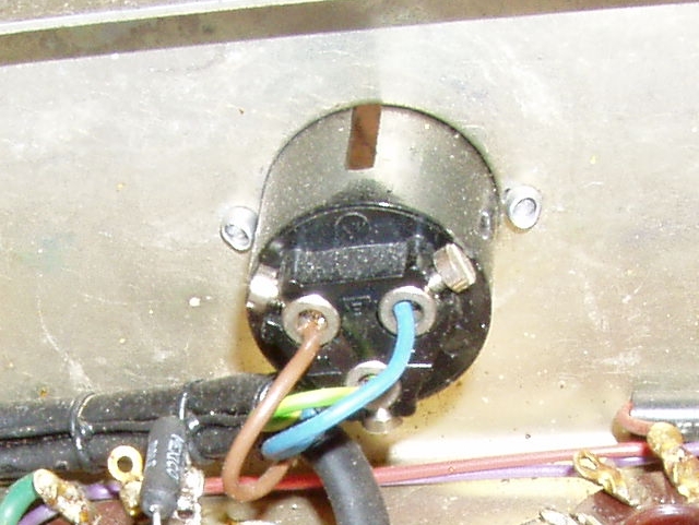

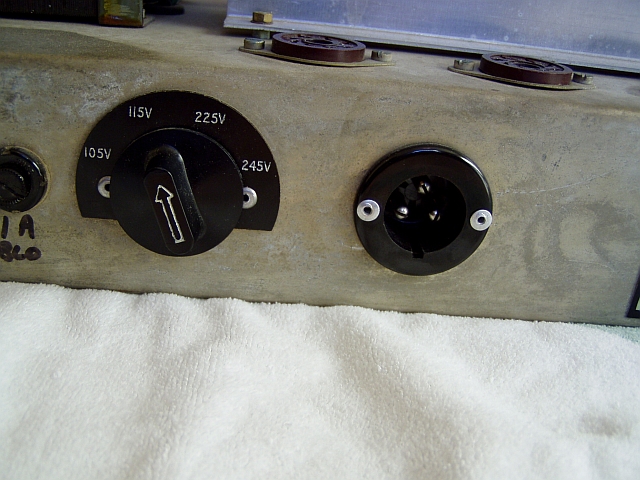

I'm not menace, but here's a picture of a Bulgin socket:
Bulgin Chassis Connector.jpg (249.41 KiB) Viewed 3708 times
...and here's what it looks like from the inside of the chassis (upside down):
Bulging - back side.jpg (205.05 KiB) Viewed 3708 times
These are quite difficult to locate - unless you have some sources in your area.
As to the filter caps, yes they are the 4 cans on the top of the chassis and one inside. In the U.S., VHR sells full kits ( http://www.vintagehiwattrestorations.co ... ucts_id=72 ). Again, I don't know who would be your most convenient source for electronic parts.
They are soldered in and must be properly oriented when installed. If one is slow and meticulous, it can be a Do-It-Yourself project. See this thread for more information: viewtopic.php?f=2&t=32

I have one Bulgin male (for the amp) spare.
Re: Hilight PA100 DR112 1973
riba2233 wrote:I have one Bulgin male (for the amp) spare.
the male is on the end of the mains cable, the female end in in the chassis.
Dr.HIWATT wrote: the male is on the end of the mains cable, the female end in in the chassis.
Um, Doctor :roll: ? The male is the end with the pointy things (on the chassis connector), which insert into the openings in the female (on the cable).
I'd draw you a picture, but this is a PG-13 rated forum :mrgreen: .
Dr.HIWATT wrote:the male is on the end of the mains cable, the female end in in the chassis.
The amp end looks "female" but those protruding pins inside might be considered "male" in some parts... :wink: :o
OldSchoolDave wrote:I'd draw you a picture, but this is a PG-13 rated forum :mrgreen: .
Perhaps Mrs. HIWATT can explain it... :lol:
