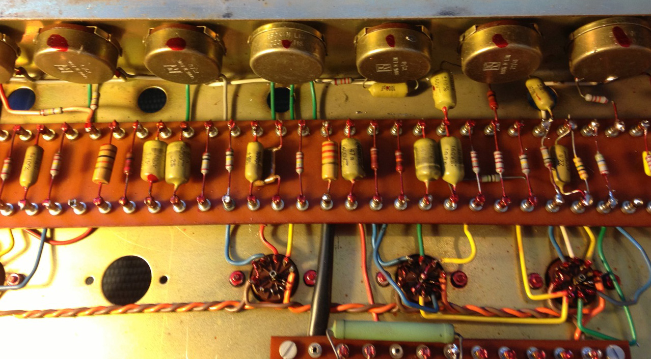

Hi, all,
A while back I purchased this Hiwatt DR-103 from 1972, from this Italian guy.
According to him, it's 'absolutely all original', although I doubt it.
It's been serviced by a qualified technician as well.
Pictures can be found here:
http://www.studioncp.com/HIWATT%20DR-103-1972.htm
I noticed the yellow cap has a somewhat odd date code. Also, pots from 1970 are used.
What are your thoughts? Heavy mutilation?
Thanks in advance for your replies!

Re: Hiwatt DR-103, 1972 - Your thoughts
Can we have a bit more information from you guys that know please? Would be good to see what you are seeing.
The obvious changes to me are the solder joints that dont have the red marker on them. The pots to me all look original and the fact that one may be dated 1970 I dont see as an issue.
The can caps look original and the yellow one dated 69 I've seen on pics of other amps, but these all get changed anyway as an accepted necessity.
The Bulgin socket has been replaced with a euro one, again seen all the time.
Would have been good to see a shot of the transformers but I'm guessing they are original as the mounting bolts have red marker on them.
Other than that, looks a clean example to me.
Preamp valve bases swapped out for ceramic. With red marker on the solder joints, even...PhilUK wrote:Can we have a bit more information from you guys that know please? Would be good to see what you are seeing.
Other than that, the obvious component change-outs. Others with sharper eyes might be seeing a bit more.
I'm surprised how clean the wires on the ceramic sockets are. They don't look melted/overheated at all, which they normally do when a socket is replaced. Most of the preamp components look original, with the exception of the two red WIMAs (which are at least the correct value). The red marker/paint is /everywhere/ (including nuts) which is not typical. The bias diode/resistors/cap have all been replaced. The small blue resistors were used for a short time around the mid 3000s (S/N). The big resistor is a replacement.
It should sound pretty much like it did originally, but it's not a collector's item.
Apparently. It would be unrealistic to expect original valves in an amp that's over 40 years old.MojoIglesias wrote: Mesa Boogie valves??
MESA creates a spec for their "house labeled" tubes and purchases from various companies that can manufacture to that spec. Nothing inherently wrong with that.
Of course, a nice set of vintage Brit valves could help improve the tone.
"I'm guessing this Hiwatt has been highly "cannibalised", or used for spare parts"
I dont agree. It's had parts replaced which must have needed replacing. The fact it has new valves is not a crime, as someone has already said, it is a 40 year old amp.
As Mark said the red marker is not typical, but here is a similar amount on 3594:
It may not be a museum example, but it probably didn't cost as much as one and if it was, would you want to use it?
I would contact the Swiss guy, say you have the amp, ask if he still has the original sockets. Ask him what work he did and why.
I would identify replaced components and MAYBE try to get either better replacements or originals. Be guided by those that know here.
You still have an amp that is original Hiwatt and from the "good years"
