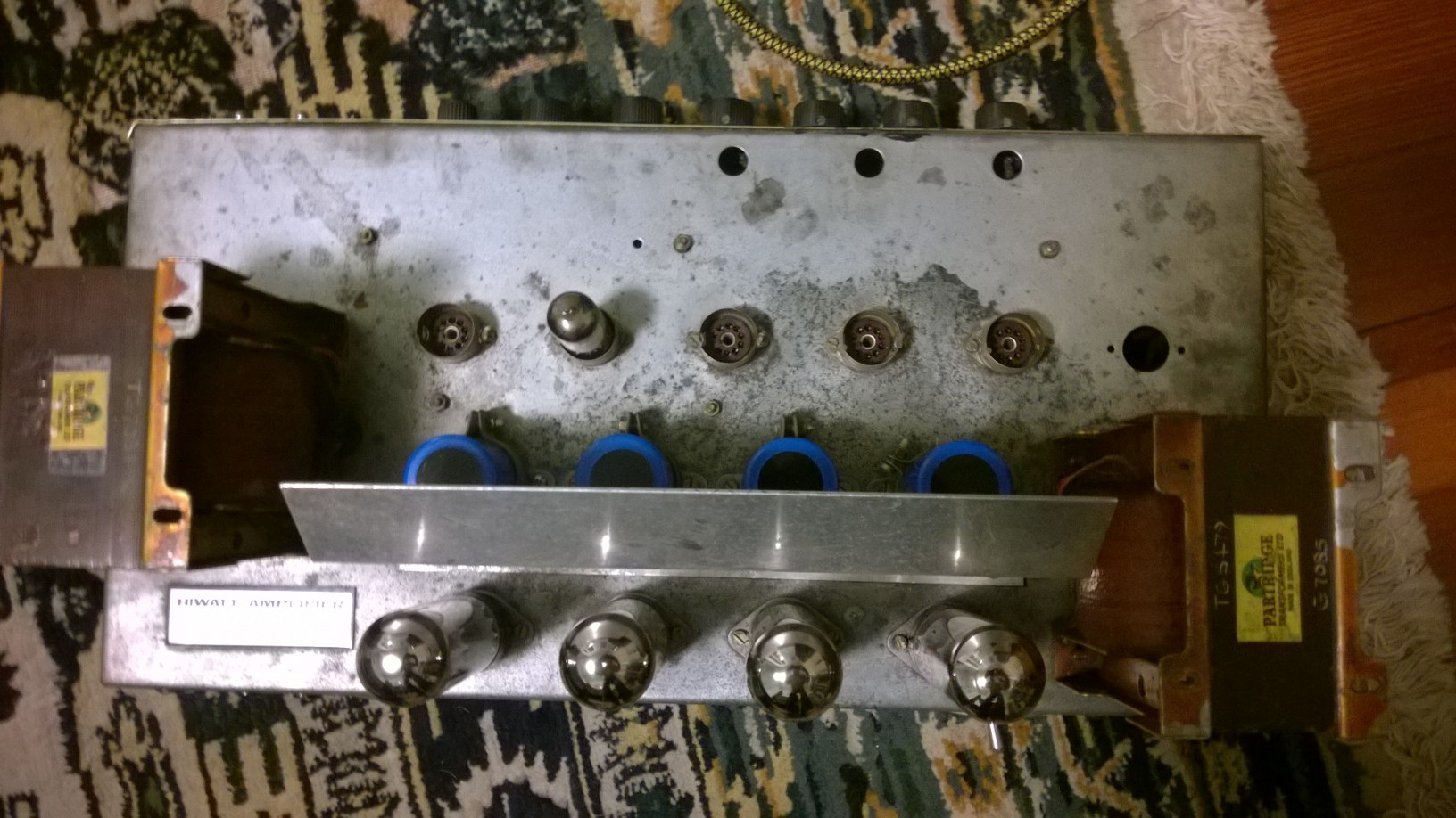

I am getting acquainted with my DR 105 which just returned from being serviced.
I asked the tech to leave the preamp tubes be since I have a stockpile of tubes to fool with.
Somewhere a I saw a spec sheet for the amp or maybe the SC L100. It mentioned there should be 4 12AX7s and one 12AT7. That is the case.
But the 12AT7 is in socket #4. I'd assumed it would be in #5. Is #4 correct?
top view.jpg (355.98 KiB) Viewed 4796 times
Re: DR105 tube question

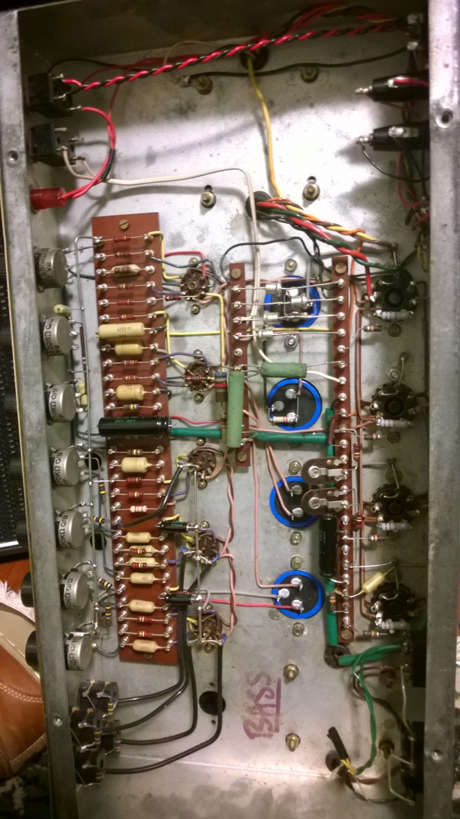

I'm not really familiar with the layout, but the PI (12AT7) is normally the second-from last tube in both early Hiwatts and Sound City amps. If you want to post a picture of the socket (from the wired side) I can confirm this.

Thank you so much for the fast response. That is where is it seated. A Mullard, no less.
Attached is the shot from underneath with the new caps and such.
If I could trouble you with one more Hiwatt newbie question: on some amps it is said that you only need to put your "best" pre-amp tube in slot #1. But this baby has four inputs. So I assume, there are at least two tone circuits? So perhaps there is a second slot which might benefit from a better tube? Which might be best suited for a 5751 rather than a 12AX7? Not that I'm all that obsessed -- I play bass!
yes,
the next to the last socket would be the 12AT7/ECC81
from left to right if facing the amp:
V1-12AX7, V2-12AX7, V3-12AX7, V5-PI-12AT7, V4-12AX7
