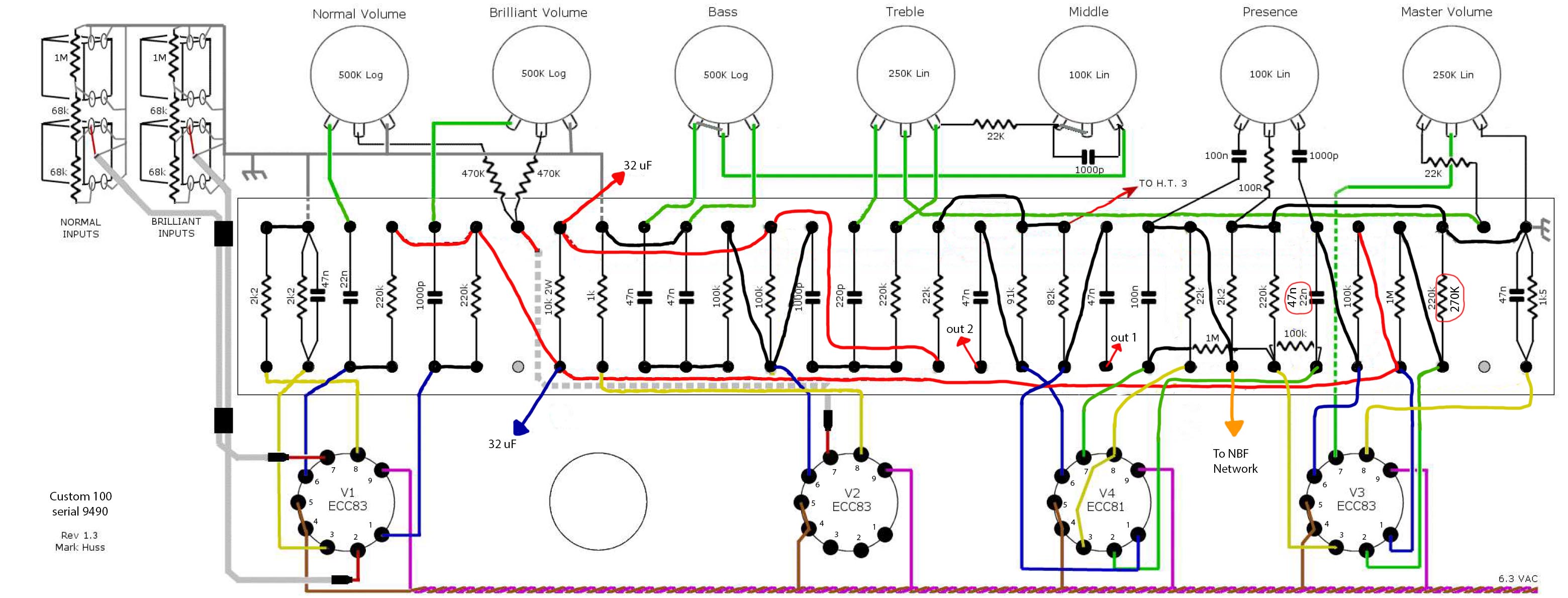

Hello everyone. I finally got my hands on a Custom 100 from 1976. There aren't many for sale in Denmark. Therefore, I recently built a Custom 100 with early 70 circuits. They both sound fantastic and very similar despite small differences in the circuit. When I got hold of an original it would be fun to check the circuit with the ones that Mark Huss has made on Hiwatt.org At the same time I made a new layout as it is in my Serial 9490 I have long admired website hiwatt.org. It is a great site with a lot of information. I have found a few little things that I want to share here. I have allowed myself to redraw a little in the 2 drawings. in my DR103 there is no 47n Cathode cap on V2. Otherwise the circuit fits. There are 2 changes in some values that I have drawn on the diagram. 22n is 47n in my amplifier and V3 pin2 grid is 270k instead of 220k. I have also drawn a new layout based on your rev1,3 mid 70 I am attaching the pictures here. Many greetings, Peter Øvad Halkjær
- IMG_3883 copy.jpg (461.49 KiB) Viewed 4674 times
- IMG_3843 copy.jpg (351.82 KiB) Viewed 4674 times
- Hiwatt_1976_v1.jpg (403.38 KiB) Viewed 4674 times
- DR_Pre4Input_v2 copy 2.jpg (465.15 KiB) Viewed 4674 times

hi Peter,
Thanks for the information.
There were many small changes year-to-year in part values and circuit tweaks as well. I've just captured representative examples on hiwatt.org.
