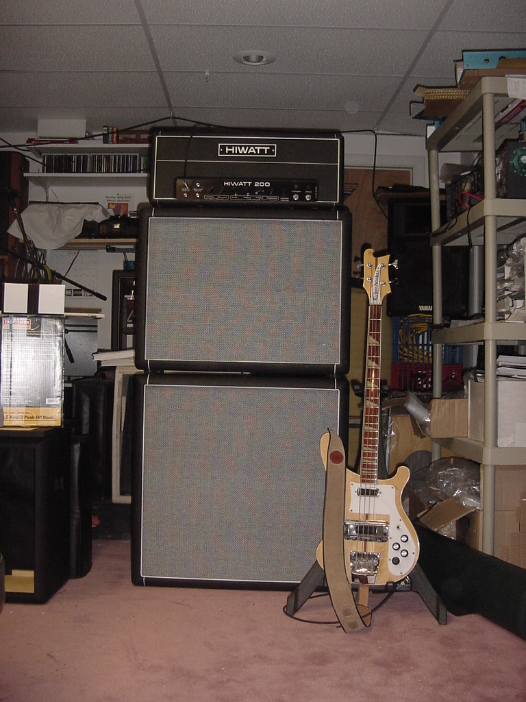

Did you guys only test with guitars or bass as well? I had Serial # 13056 from around 77 or so. Played bass through it for years and just loved the EL34 version over the KT88's. With my 401 Rickenbacker she just rocked the house down!! There is a review of the amp on our DST website under Tech Information if any one is interested in just how much power the DR201 has and the massive amount of voltage running through those amps!!!

Bass Rig
Bass Rig
