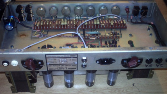

I've taken photo's of my amp and have tried to include this mod and I'd be very grateful if anyone can help/advise me
about,not only what it is,but also whether or not I should use them or remove them. I realise it's better to have

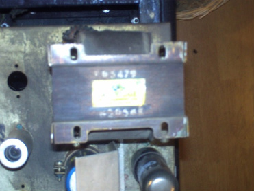

everything original,which as far as I know,mine is and I'd like to maintain it so. The other thing I wanted to ask is,I've
noticed my tranny's have non-corresponding no's on them,one's H2 and one's H3 I think,was this 'normal' practice or does
it mean one was replaced?

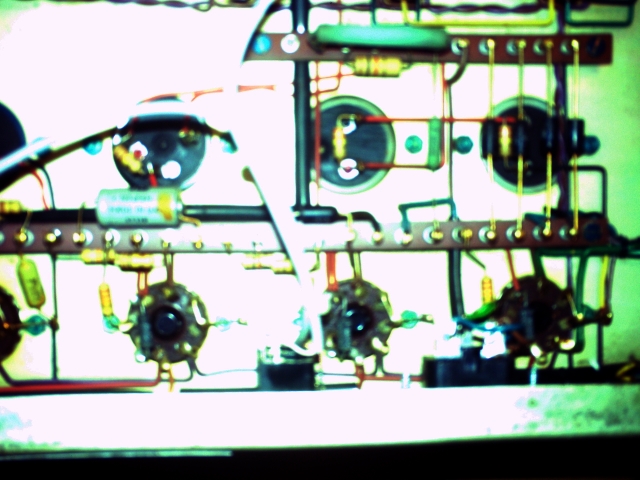

It's hard to tell from the picture you posted. It looks like one gray coax is going to the master volume (which would make me think line out/passive effects loop) but the other gray coax seems to be going to the speaker jacks.
A close up of where each coax connects would help.
If those extra jacks in the middle are grounded to the chassis, it could be causing to a ground loop with the mixing desk.
If you post the full numbers from both trannies, someone here can likely answer your question on that topic.
Re: I've got 2 extra outputs on my '74 DR 103.Any ideas??
If you can post more straight on, close up pics, we can tell you more.

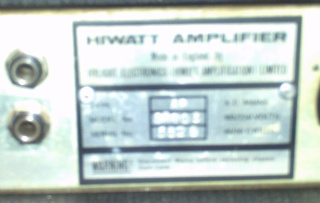

Hi guys,
Thanks for checking it out. I have taken some better pics,(I hope!). My canera isn't the best quality I'm afraid .
Mark,I tried to get the numbers off the trannies but they are a bit difficult for me to read. I've added a pic of each as I
thought that having seen others for comparison,your trained eye would be more accurate than my complete novice
view,(and failing vintage eyesight). I hope they are ok,if not,please let me know and I'll have another go when I'm sober!

Sigh, those pictures are still not shedding a lot of light on things. Do you have a child or friend you could borrow a better camera from?
On closer inspection, it looks like the extra jacks have plastic sleeves, so that should not be be causing a ground loop just be being there. However, it appears the line outs are referenced to chassis ground, so an overall ground loop is still likely. You might want to try an isolation box (basically a 1:1 audio transformer) between the amp and the desk.
