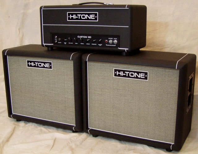

A 30w head and TWO 1x12 cabs :D !
From today's photo shoot:
Re: HI-TONE cabs
Or, for the low rider fans:
Re: HI-TONE cabs
I love the little double stack! 8)
