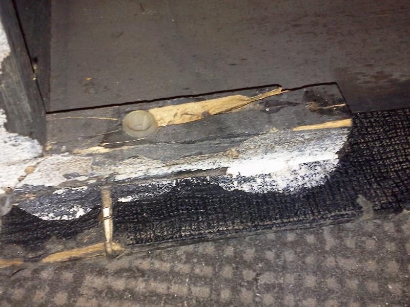

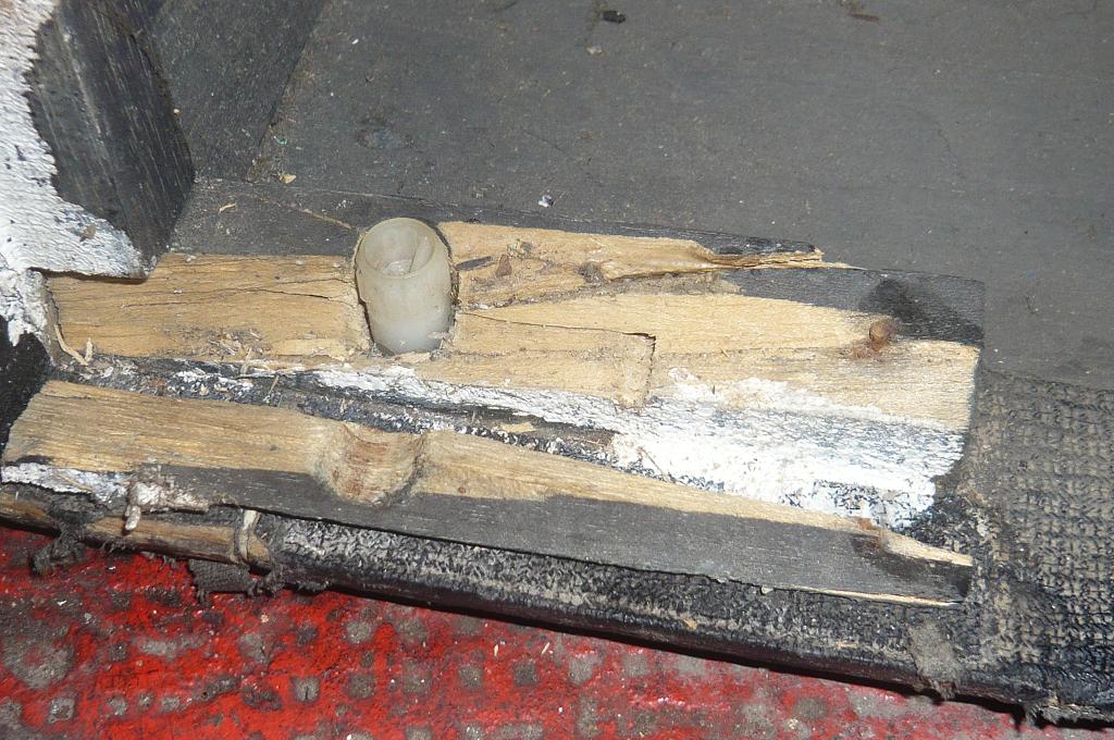

Here is the progress.
1. fixed the broken bar with wood glue and clamp:
Before
Before
After
After

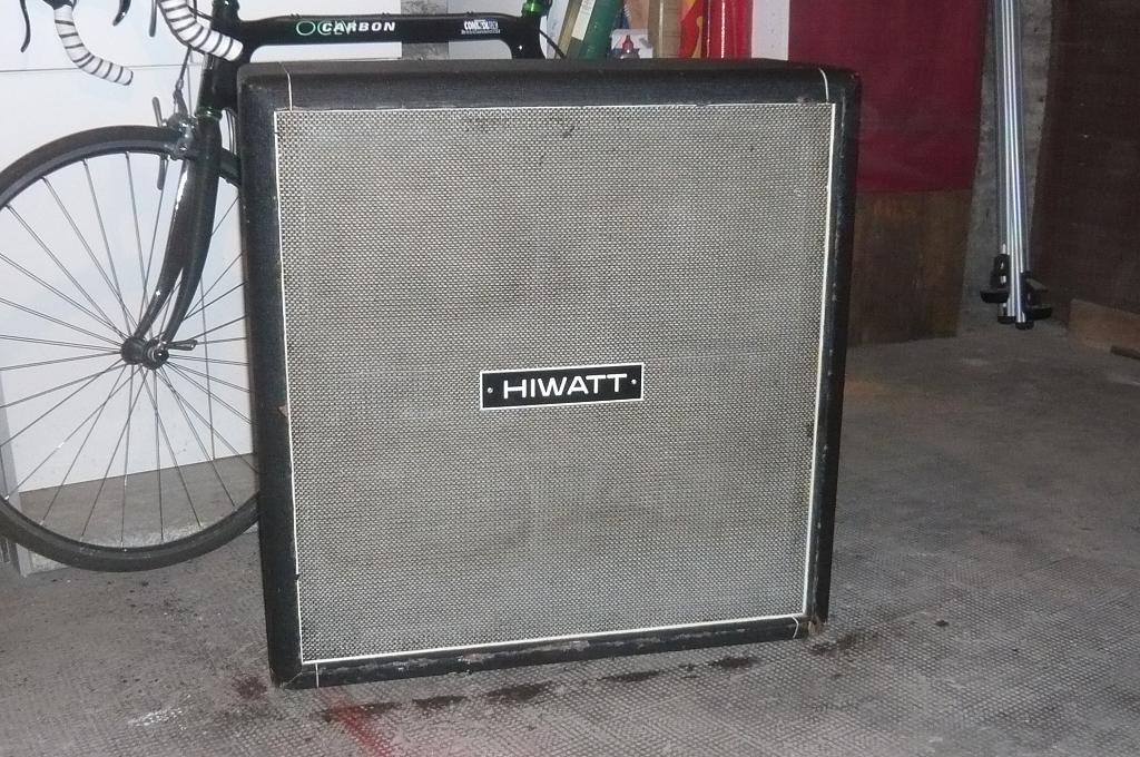

And here is the progress with the grilcloth:
Before
Before
2013-04-15 18.13.30_r.jpg (209.82 KiB) Viewed 6048 times
After
After

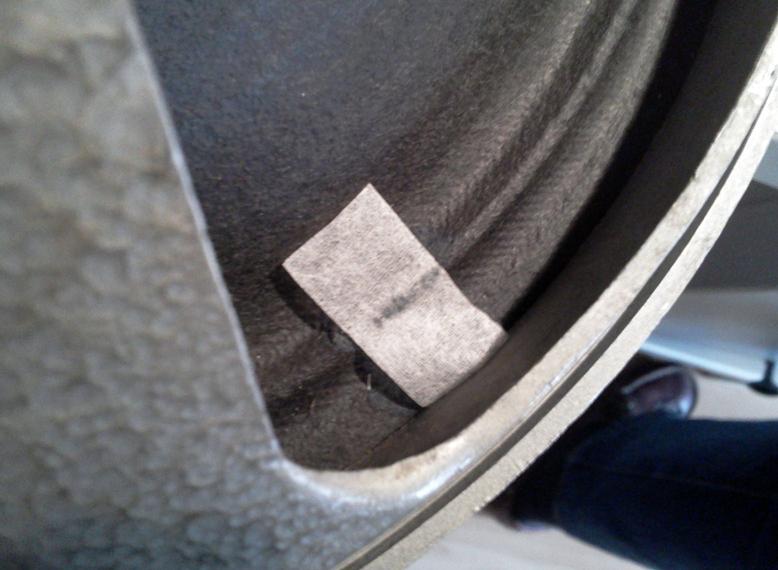

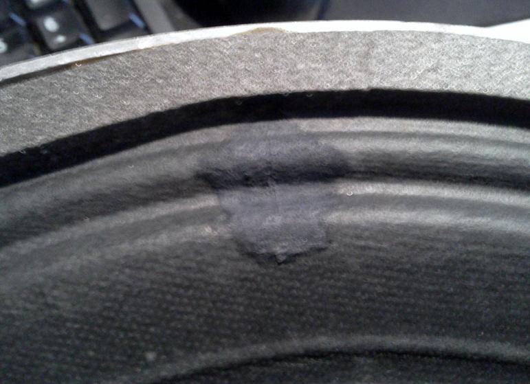

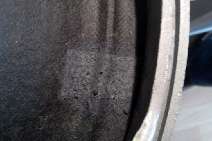

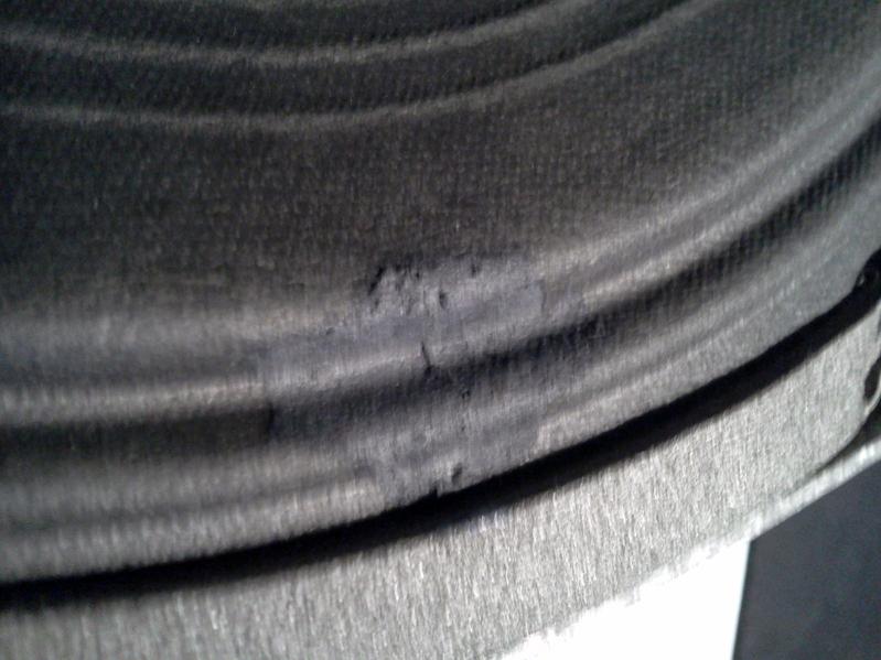

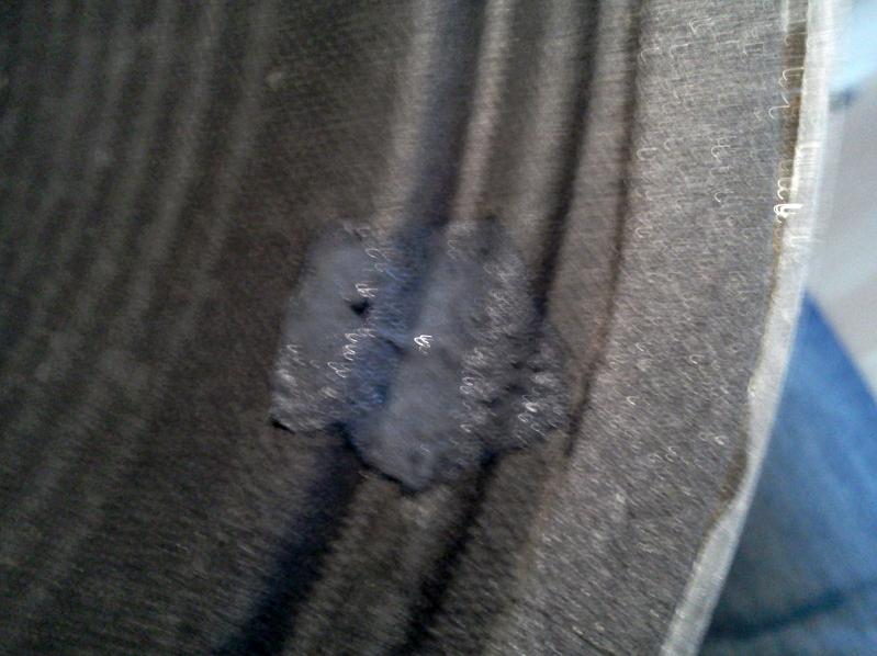

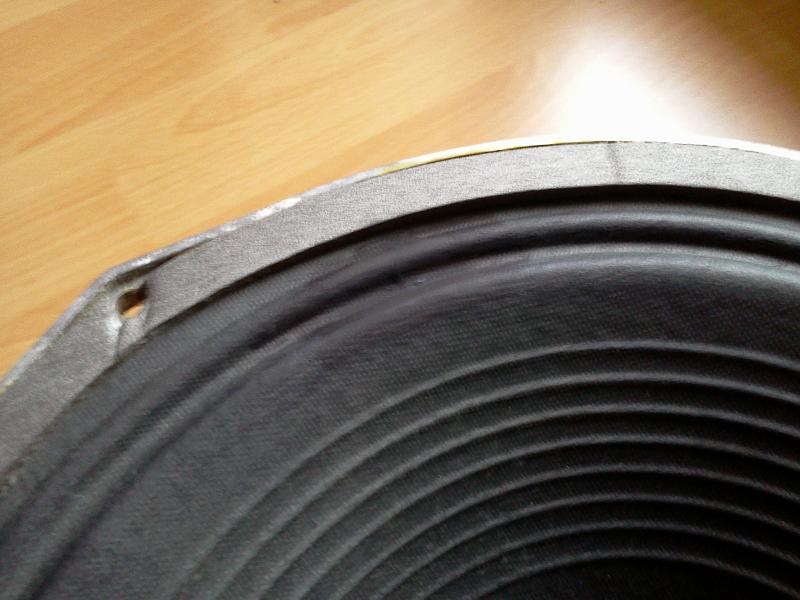

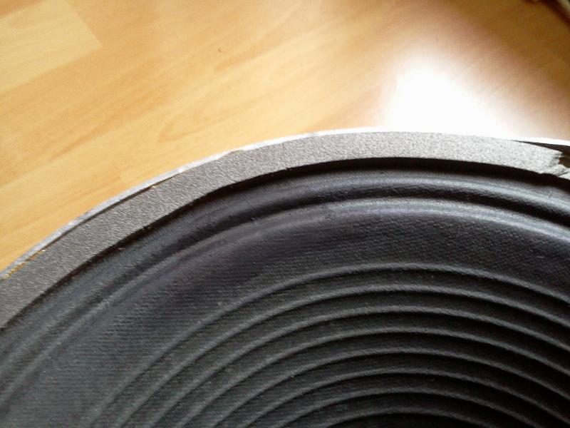

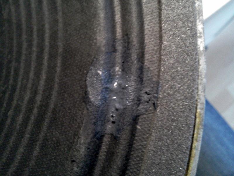

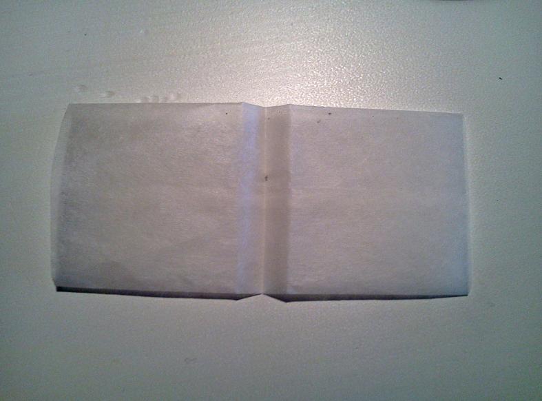

As you remember, there had been two speakers with tears inside the cabinet. One really bad, and one only with two small ones. Know i fixed the easier one. I used a teabag, Pattex glue 1:2 with water, cigarette ash for colouring, black marker and alcohol for the final finish. Here are the fotos:

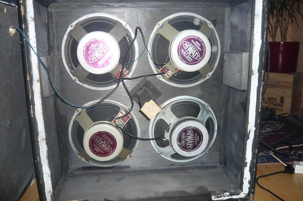

Hello, today mounted the four working Fanes. Finally a great sounding halfstack:
Re: Hiwatt 4x12 SE4122
Congrats!
Nice work on the speaker repair. I hadn't thought of using teabag material, but just might try it next time.
