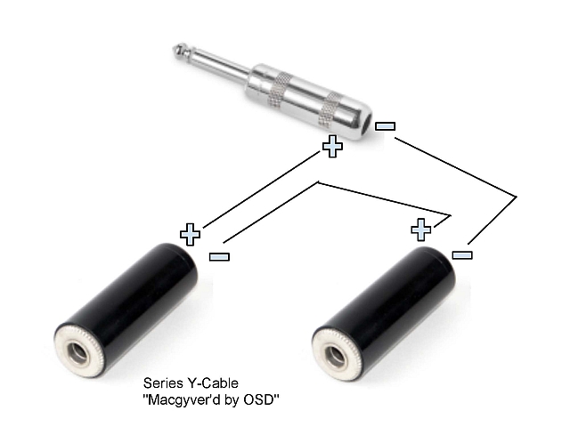

the amp is stuck with the 4,8,16 ohm options.
You are "probably" safe running both cabs with the amp set to 4 ohms.

Hmm.... well.. would you do it? haha.
Re: DR201
Only if I was in a pinch. I don't like to mismatch impedances.

Re: DR201
NO! Hook up the cabs in series and set the amp to 8 ohms.
EDIT: Here's a down and dirty sketch of a Series Y harness. You could substitute Male plugs for the Female jacks. Just make sure everything is plugged in before firing up the amp.

Re: DR201
Excellent idea Dave!
I can't believe that I didn't think of that, but that is what you highly knowledgeable and experienced gents are here for!

Re: DR201
The series idea is best. You can either make up a cable as Dave suggested, or duplicate that connection in a small box and use three normal cables. I like the box better, because 'normal' cables are easier to find and replace in a pinch. If you make a box, use standard Cliff/Rean plastic jacks like those on the back of the amp to avoid shorting the sleeve connections together.

Great! thanks!
So set the amp to 8 ohms, plug this cable into the amp and the two other ends into each cab? (just double checking!)

Re: DR201
nightterrors wrote: So set the amp to 8 ohms, plug this cable into the amp and the two other ends into each cab? (just double checking!)
Correct. That particular Y junction will create a Series connections between your two 4 ohm cabs, resulting in an 8 ohm load to the amp. Realize that if one or the other cab is disconnected, there will be an open circuit (no sound, no load, be careful).
nightterrors wrote: Where can I get a cable like this that is durable?
AFAIK, you'll have to make one. I've never seen one commercially available. I do like Mark's idea of a box (with insulated jacks), as it'd be more durable. But, if built correctly, a Y Cable can be plenty stout.
