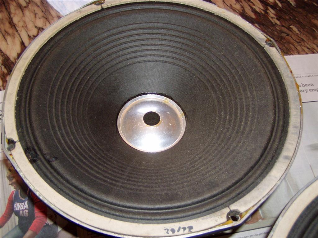

The 122190 Sound City Fanes used 14,000 gauss magnets, which would make them closer to a 122231 Hiwatt Fane than a 122142. They originally had 102 006 cones and were rated at 40 watts.
What are the dates on your Fanes? I have a quad of 122190's from '71/72. They have cast frames and aluminum dust covers with felt "deadeners" glued on the centers. The ones that didn't have scratchy voice coils sound good. Similar in character to the 122231, but the aluminum domes brighten the up a bit.

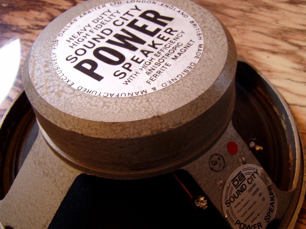

Re: Sound City Fanes vs Hiwatt Fanes
foster wrote:I'm sorry but I'm not able to post pics here...maybe 'cause I'm using a Mac?
We don't discriminate here ;) . Not sure why it's not letting you post. Maybe we can take that conversation off-line tomorrow (Friday) and figure it out.
I stand corrected! Just looked at the pics of my 122190 dated 29/72 and it also has a 1021 11 cone. My '71 issues have the 102 006 cones.
Sounds like you've got an original quad there - very nice. Do they look like this?:

Hi Dave,
the front side looks exactly the same, but rear the magnet seems not so big..and thy don't have any label over the magnet.. only a label on the cast frame of each one
If you PM an email address I can send you the pics so maybe YOU can post them..
Thx
Mario
PM Sent.
Not sure how large the magnet on that one is (besides the 14,000 gauss rating). What you're seeing is a plastic magnet cover, painted to match the frame. Your covers may be missing?

Yes Dave,
I think they're the same speakers but without the covers..
