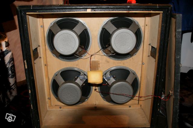

Dr.HIWATT wrote:My answer is "it depends". The earlier the Sound City then the greater the chance that the speaker was very similar if not the same. There is a model that DR had a hand in the design of that I have seen in SC and HIWATT SE4122 cabs. This is the 17,000 gauss, 50 watt, 15 ohm speaker. They are an outstanding speaker
Might this be the one? Anyone want to take a guess at the age/vintage of this cab?

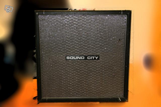

Bump, as I'd love to know if these speakers are worth my consideration. I'm trying to slowly assemble a Townshend@Leeds kind of setup, and if these are similar to the speakers used in 4122 cabs around '68-'69, they might be a good candidate? Furthermore, is that grille cloth similar to the herringbone on the pre-70s Hiwatt cabs?
Re: Hylight Hiwatt Fanes VS Sound City Fanes
I can't read the label clearly, but I think those are the good ones.
The cab is very cool!
shakti
Posts: 214
Joined: Sat Oct 11, 2008 4:59 pm

Post by shakti »
That sounds promising...what kind of timeframe are we talking about?
that cab looks like '69-70ish...It is hard to really pinpoint.
I would get it just for the "rock and roll circus" mojo.
I would think it should sound good as long as the speakers have no problems.

Post by shakti »
Actually I'm shooting for a Rock 'n' Roll Circus kind of vibe as the amp I'm planning to build is a SC105, but possibly with a Hiwatt badge or even no badge...exactly like at the RNRC.

Post by shakti »
BTW, what are the correct cone codes for these?
010 003 or 010 015 pulsonic cones

Post by shakti »
The cone codes are 1 x 102 006 and 3 x 102 012. I recognize the 102 00x type from Celestions of the period (003 is a 75hZ resonance cone, and 014 is a 55Hz version). I would have to ssume these are original cones, but what does that make of these speakers? The cab isn't super-cheap, so if I spring for it I want to know I'm getting something that might nail the Live at Leeds tone.
