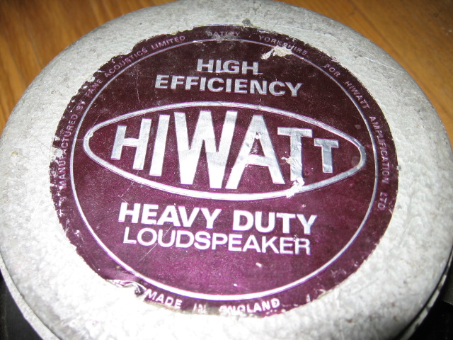

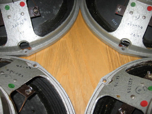

foster wrote:Hi Dave,
since I don't know how to upload the pics here (sorry...) I've just PM them to you.
Ah, there they are!:
As I mentioned in PM, those were not particularly valuable models when in original condition - at least not for guitar usage. Finding someone to properly recone them is a challenge in the U.S.. Not sure what options you have available in Italy.
In any case, it appears as though the seller is asking far too much money for those speakers. If they were original 122231's or 122142's, it would be a different story.
regards,
foster
regards,
Thank you Dave, I'll wait to find a quad of 122231/122142's.
