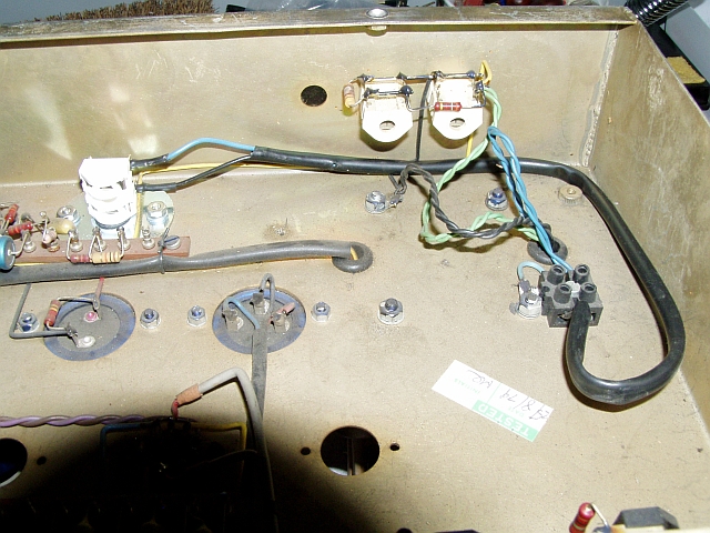

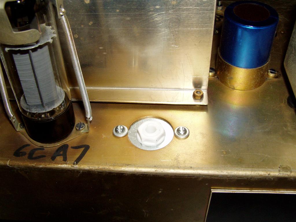

This summer, I did some work to my SA212. Frustrated by the fixed speaker leads, I decided to mount a speaker jack in an unused Power Tube socket hole. That allows for removal of the chassis without desoldering the speakers - and was a non-destructive mod. Note in this picture there seems to be a separate tap running to the External Speaker jack. This jack is labeled 16 ohms on my SA212. If you do use 8 ohm speakers, you could re-route those leads to the Internals. For your transformer's sake, I would leave the External jack disconnected (search the forum for another discussion regarding combo output wiring). Perhaps Professor Huss will weigh in on this.
Output Jacks 01.jpg (277.07 KiB) Viewed 3577 times
Here's what the speaker jack looks like from the other side of the chassis:

Hi, Dave,
Thanks for the pictures!
I have modified both of my SA212 combos and have installed a speaker mount on the unused hole beside the slave out. So now I can connect either the internal speakers or an external cab to the corresponding output jacks (correct impedance can be chosen). Of course with this setup it would be impossible to use the internal speakers together with another cab at the same time, but that is not a problem as I use the internal speakers exclusively at the moment. In case I plan to use additional cabs, I would implement your solution.
