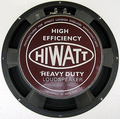

The speaker in it is a Hiwatt "high efficiency heavy duty" speaker. Designed in England, probably made in China, but I do not know what that means in terms of specs. It has GSP-12/175-8 printed on it.
I think that this code may translate as: 'Guitar SPeaker'-12 inch/175W-8 Ohm, but I have seen others claim it to be a 100W speaker. Picture attached.

I am considering replacing it with this: https://roostamp.com/products/fane-hiwa ... ar-speaker
Do you reckon that I'll see much of a difference between these two speakers? Is there something else that may be a better option?

"175" might also indicate voice coil diameter
I don't think buying the speaker you propose would add much of anything; I think the newer HIWATT/Fane speakers may be manufactured in China as well if that matters to you.
