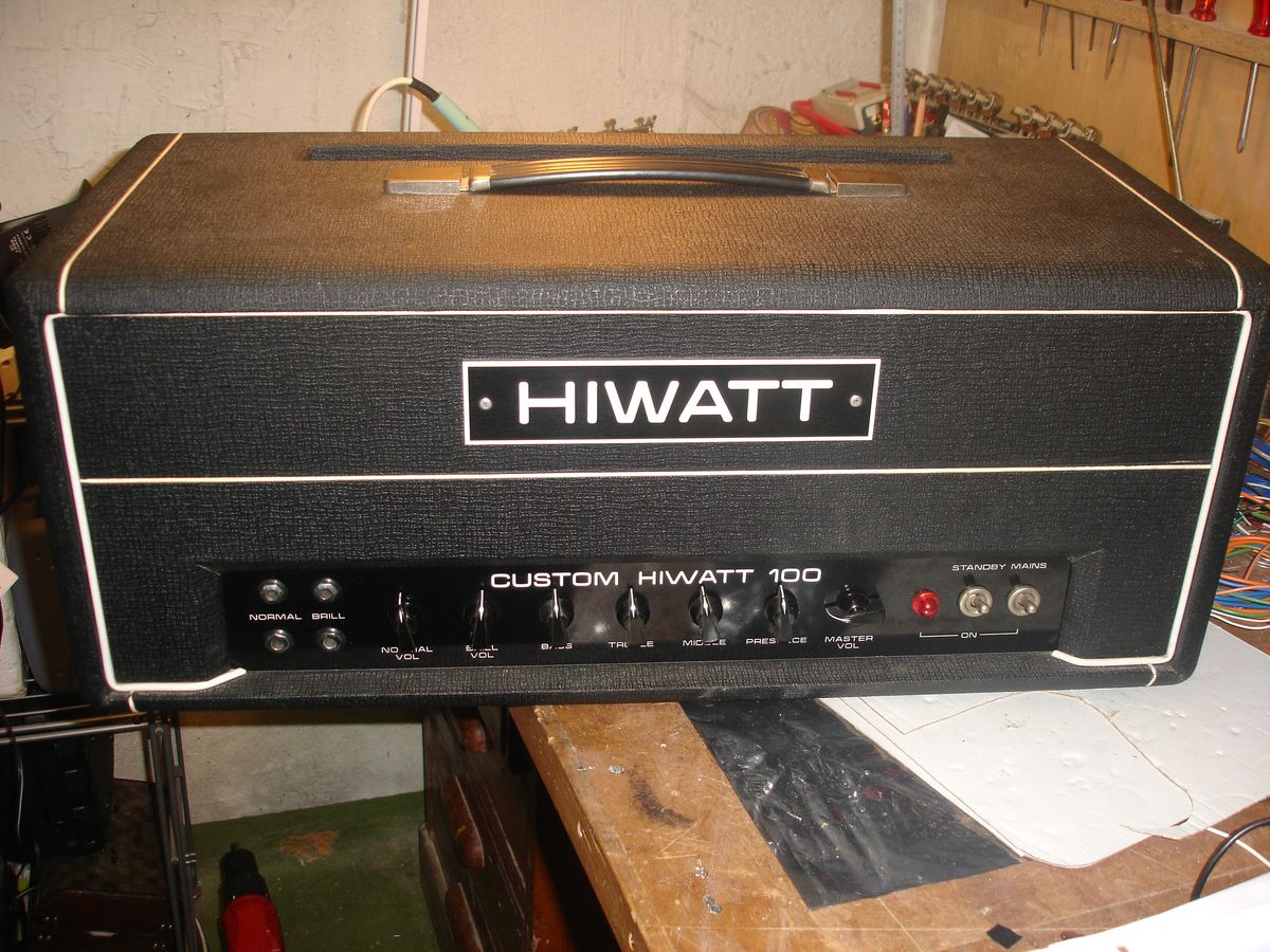

77' DR103 --> S/N: 10111....in damm good shape....i think wasn't open till now.... :lol: for shure...
the baby will cry @ 20 o'clock in the band castle!
cheers from a happy owner
raffa

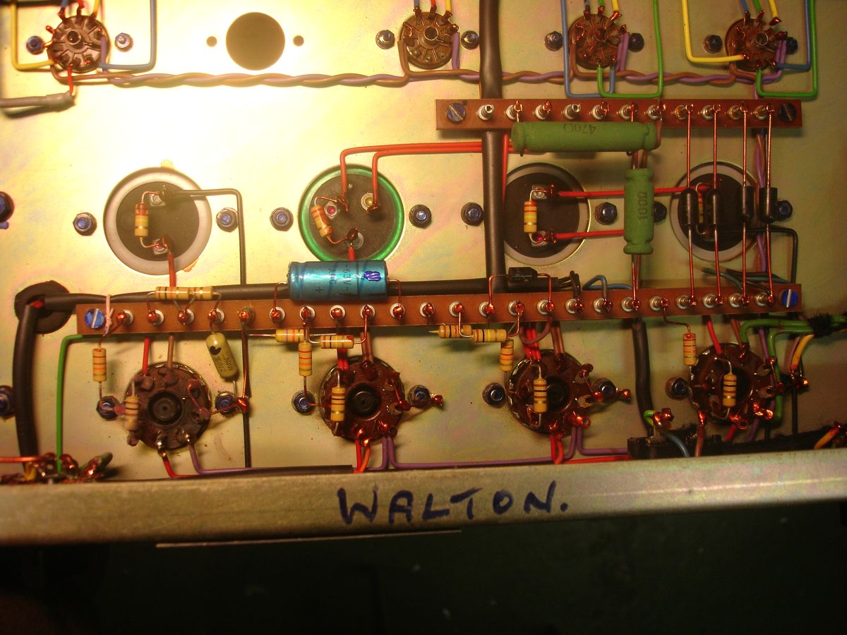

...did someone realise the first left tube? ....was a little bit warm, isnt it?
what can that be?
Re: my baby it finally in my hands...
raffau wrote:...did someone realise the first left tube? ....was a little bit warm, isnt it?
what can that be?
Looks like the screen grid resistor got a little toasty? Those are a common "weak link" and are often replaced with 1K 5 watters for safety/reliability. Your call on whether or not to swap out original components on a pristine Hylight, though.

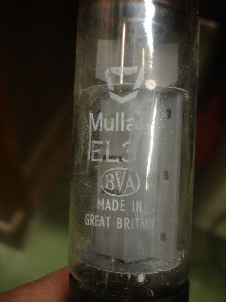

it looks like a power tube died at some point. I wouldn't do anything unless your bias is Very far off.
I wouldn't mess with such a pristine amp........but that is just me.
